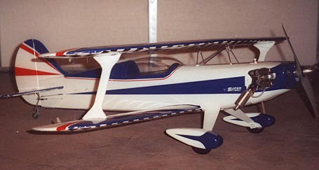

Build it as light as possible because they usually come out heavy. mine balances with a saito 120 with the battery in the plan location and weighs a smidge over 10 lbs. definetly use ailerons on both wings but mostly figure out a way to build it lighter

Those are some nice pictures. I take it you got the fiberglass cowl instead? I'm thinking of doing the same. I don't want to deal with the 2 piece plastic GP kit cowl.

Yeah, I bought an Aeroglass cowl from Dave at Quantum Models. www.quantummodels.com I think it was around $25. I might still build up the ABS one with the kit, but have read that the ABS plastic cowls don't hold up very well. My only other deviations from the kit plans are a pull-pull rudder connection, and I'm going to use a dual servo set-up with a reverser on the split elevators as opposed to the "Y" rod single servo set-up. Definitely going to go with the ailerons on both upper and lower wings as recommended by others.

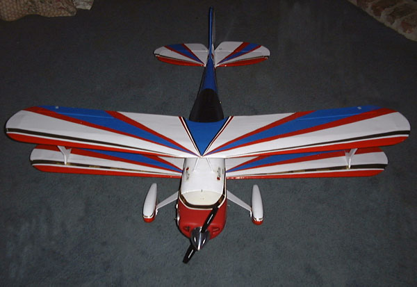

The first kit I assembled and at a young age with no experience. I wish I knew that before I got it . It took me 6 months to complete and it was hard. No help from anybody except from somebody who silver soddered the cabane strut.
I was so fustrated building this kit. I only want a nice arf to build.
There are a few places on the Skybolt which have thicker (3/16" I believe) sheets to bend into place. The belly section under the nose comes to mind!
This was my favorite part
