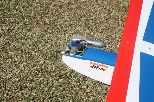

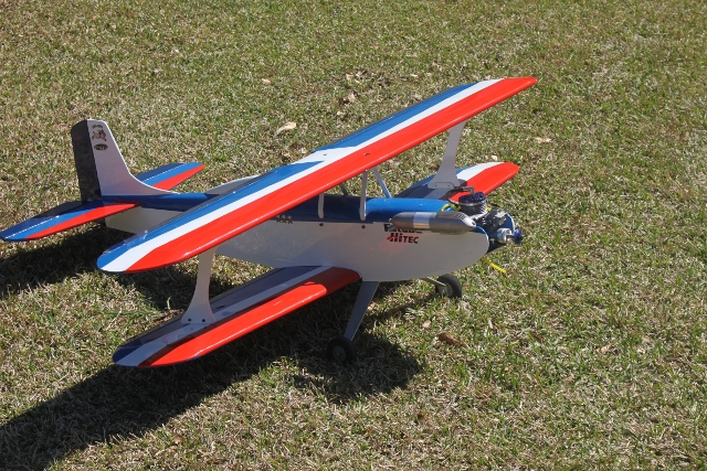

Mine has a Evoloution 15cc gasser in it, flies great
Richard
