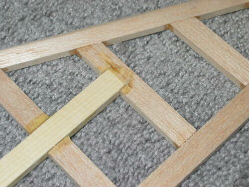

Here is a close-up. The spruce stock fits into a pocket cut into the balsa. Epoxy was used here, and Med CA everywhere else.
