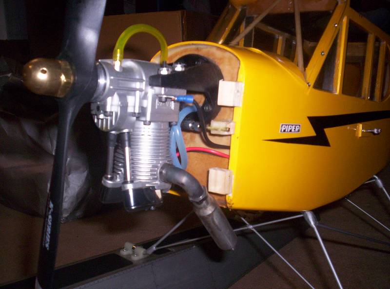

Ok , thanks for the advice gents. Went to to the LHS with fairly firm intentions of getting a 4 stroke 65. After lengthy conversation went with a 2 stroke evolution 60. Now am being challenged mounting it. Have knocked out blind nuts, and need to glue dowls in there. Made pattern for the 60 but doesn't fit easy.9 oclk mount is above firewall. 12 oclk almost entire thing is going to stick out of cowl. 6 oclk mounts to high on firewall. Is cutting mount down and drilling new holes in it a bad idea? also maybe i should get pitts muffler before deciding.Thinking new motor mount is the answer. Will be going back to LHS soon with firewall, engine, and my mounting pattern.By the way i'm getting close to finishing 2nd wing section.Will need to get back to the fuslage and this is step one .

Did he (LHS guy) talk you into the Evo because it's what he had on the shelf? It ought to to be enough power, for sure. Side mounting the two stroke is probably your best option, a fair compromise between aesthetics and reliable running. Mount it with the cylinder to the right.
I'm curious to know what the LHS guy said to convince you to go 2-stroke. They may take a little more work to set up well, but it's worth the work, and not difficult. You may have to try a different engine mount to get it (the Evo) to fit. My inverted .65 in my Sig came close to the top of the firewall, but the engine is almost totally enclosed within the cowl. I used a DuBro antivibe mount. On my H-9 Cub I used a Dave Brown mount, and I recommend it highly. The part that goes against the firewall is round, and has marks you line up on the crossmarks that you make on the firewall to center your engine, makes it easy to center everything.

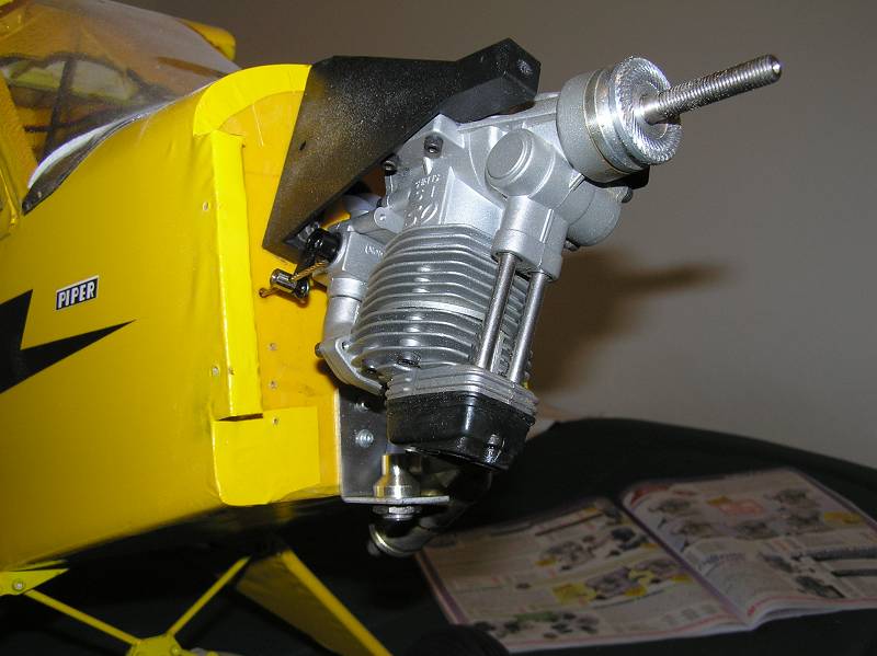

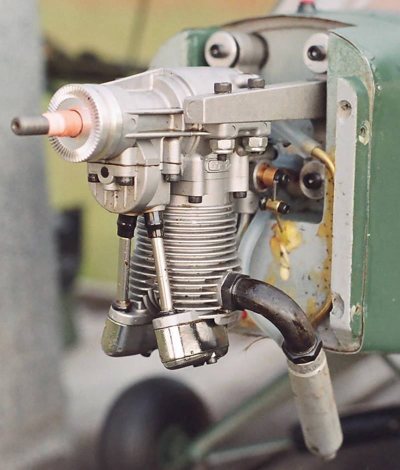

I flew mine with an OS .52 and it flew VERY scale-like and didn't have any problems flying off grass.

Khodges the round mount looks like there's lots of fire wall room left. Tailskid doesn't top right engine mount bolt. Come threw were stringers attach on back side? looks like mount is right to the top.+ Did you drop the thrust line a little bit?

I really like the Dave Brown mounts (round one). I also like the DuBro, but it takes up more space behind the engine. I had to recess the firewall on the L-4 for that mount to work, and even if the mount comes right to the edge of the firewall, with the cowl in place it won't be seen. I did not drop the thrust line, as I was trying to maintain a very scale appearance; since the boot cowl slopes down a little along the top, recessing the firewall actually gave me a little more room at the top of the firewall.

"Tailskid doesn't top right engine mount bolt. Come threw were stringers attach on back side? looks like mount is right to the top.+ Did you drop the thrust line a little bit?
Thanks"
Yep, a bit of the motor mount was grinded and it was a tight fit to get that blind nut in there, but it fit! I tried NOT to change the thrust line and did the best I could and the way it flys, it appears to be right on.
