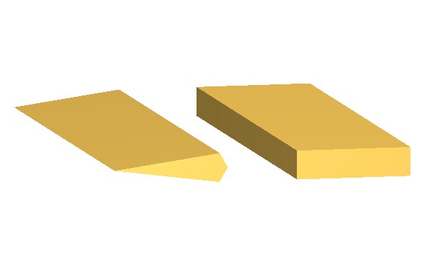

Can anyone advise the best way of profiling a solid piece of balsa to form an elevator/rudder section as per attached sketch - a method for forming the bevel on the front edge and one to create an accurate/consistent tapered profile.
Many thanks.

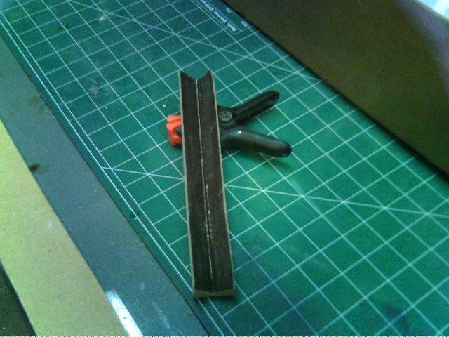

Big 10-4 to Broken Wings, been doing it that way for many years. I even use a power sander with 80 grit paper and it doesn't take very long to shape it. As far as the LE I have a tool - see picture
