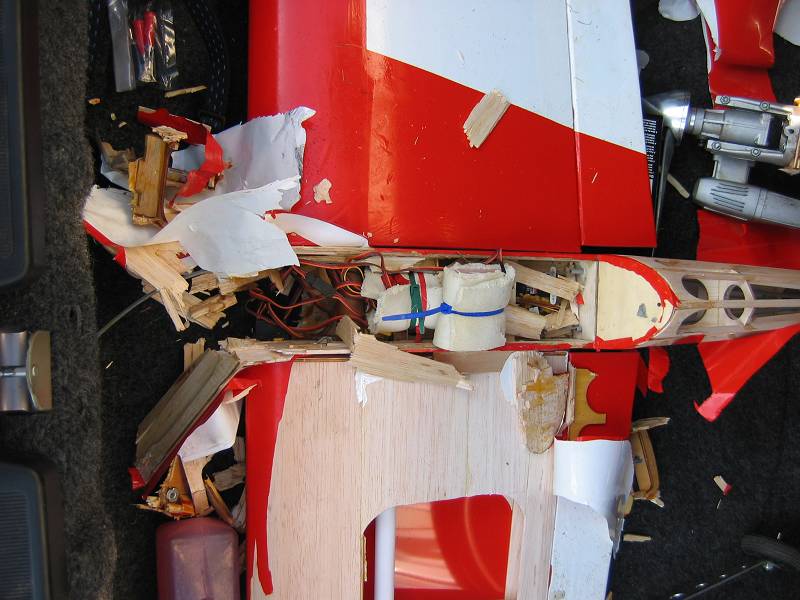

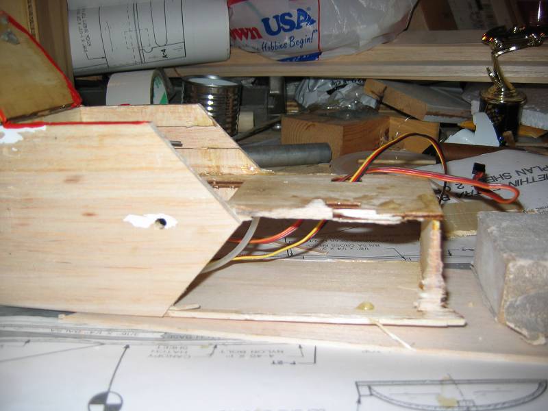

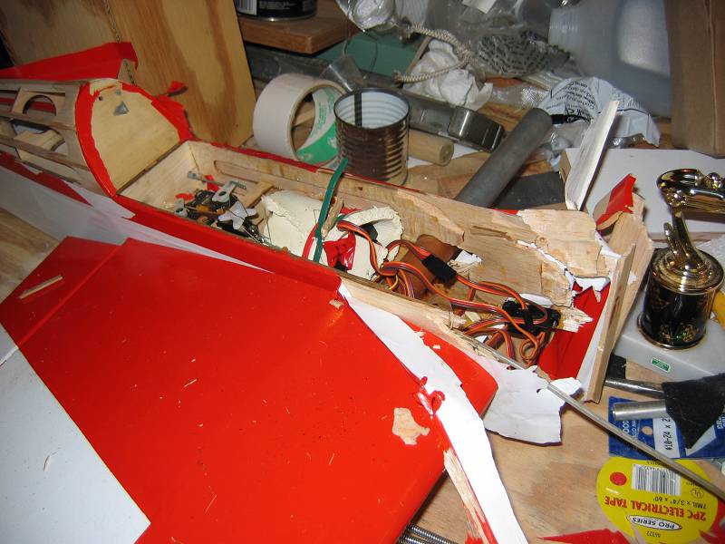

Over last summer in august i think??? i crashed my SE bad. The fuse was completely destroyed back to the little hole for the dowel that lines up the wings. All the stringers behind the cockpit were popped out of their spots, I found the cover to the radio compartment about 20 feet away from the plane when it crashed. I ended up fixing the fuse then putting it on the shelf for a while, it had minor damage to the wings and countless other little things that i just never got around to. I bought an RC truck, sry guys, but it was cool when the cops clocked it at 44 across a parking lot, they thought it was cool too

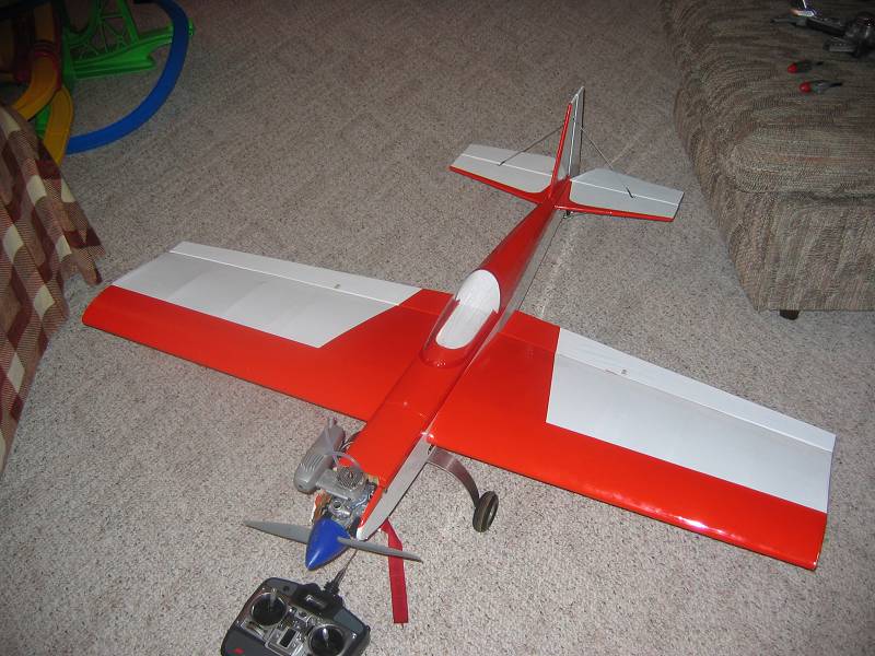

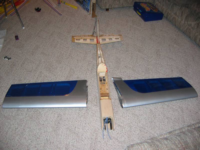

anyways i finally got done with most of the work, i still want to counterbalance the rudder, but the wings are rebuilt and covered, the fuse is all sanded down, just need more covering. I noticed one possibly fatal mistake. The covering scheme kinda sucks, i like the colors but it will be almost impossible to see very far away, im gonna give it a try and keep it pretty close, but if it gives me big problems i'll recover, i don't want to, but i will. heres the pics so far, lemme know what you think.
I have made the ailerons just a touch bigger
, and the plane ended up being 1/4in longer than it was originally, not worried about it
I do have one question.... How do you seal the hinge gaps?
Thanks, Joe

Nice job on the rebuild, and yes you're right, blue and silver aren't the most visible colors in the air. What you might try is to add a few white stripes for oreintation. Hinge gaps are normally sealed by cutting strips of clear covering and while the control surface is deflected ironing them into the gaps.
