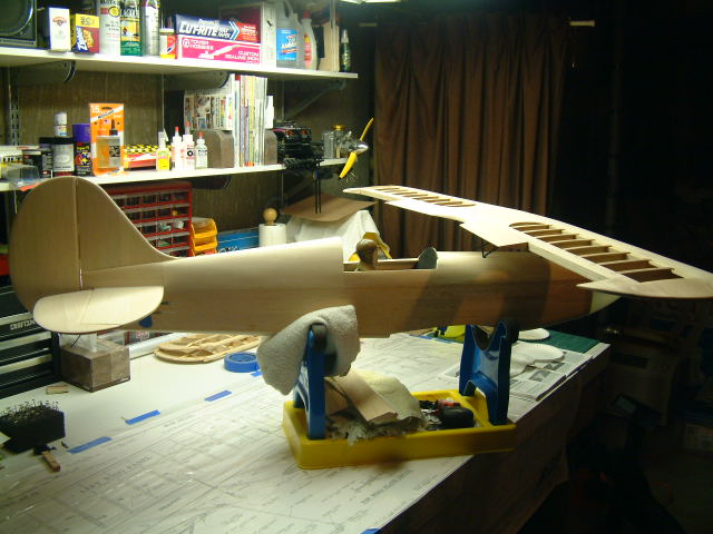

I considered both the SIG and the GP Skybolts, and decided upon the GP version. From the searching I did it seemed like the better of the two kits.
If anyone is interested, I've been keeping a website with the build progress. Enjoy!
http://home.maine.rr.com/wydah
-Fitz.

TopGun: Very nice indeed! How well does she fly? What engine are you running, and what's the finished weight?
Tim: Bench is about the only thing I try to keep cleaned off. The rest of the basement is a total mess
LQ: Got any pics of the bolt u just finished?? Would love to see them.
Joined the bottom wing halves tonight. More sanding and bottom wing sheeting perhaps tomorrow night ....

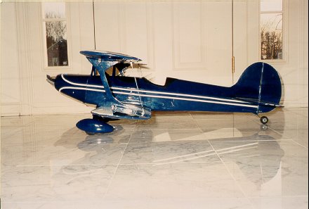

here's my Sig Skybolt, built at the age of 14. And it won 2nd place at our mall show in Sport Scale (back in early 90's). it was a builder's kit, but not as bad as it seemed. probably a bit heavy by today's standards.

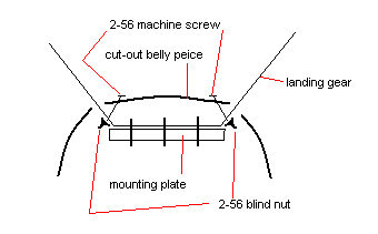

Chuck I, you have to wait until Saturday when I get my hand on a digital camera to show you some real pictures. But if you are as anxious as I am when it come to model airplane, I jsut quickly put together a (loudsy) sketch of what I am talking about. This is the straight view from the front or the rear of the plane. The plane is up-side-down.

Chuck I, at last I got a hold a digital camera to show you the pics. Take notice of the blind nuts that I epoxied on top of the main gear. I bent the 3 teeth on nut back flat to the washer or you can cut them off. I drilled the holes for the blind nuts slightly larger. This way I can tilt the nuts in the direction I want then expoxy it in place. I expoxied the blind nuts with the belly cover mounted to the gear. I did not need to mount the gear the plane to do this. Mount the belly cover to the gear then expoxy the blind nuts. When it dry, the nuts will tilt in the correct direction. Notice, the un-painted area on the gear is where the gear mounting plate fit. The blind nuts just go next to the gear mounting plate. You don't want to drill extra holes on the gear mounting plate to weaken it.
I also used blind nuts to mount the main gear. I did not want to use the provided wood screws. After all, the whole reason for making a removable belly cover is to replace damaged landing gear. This is a 10.5lbs airplane, the provided landing gear is too weak for it. I welded supporting brace made out of 2-56 pushrod between the gear. Also, notice the recess hole on inside of the belly cover for one of the rearward hex screw. The screw cap recess into this hole. Hex screws are much stronger than those wood screws.
