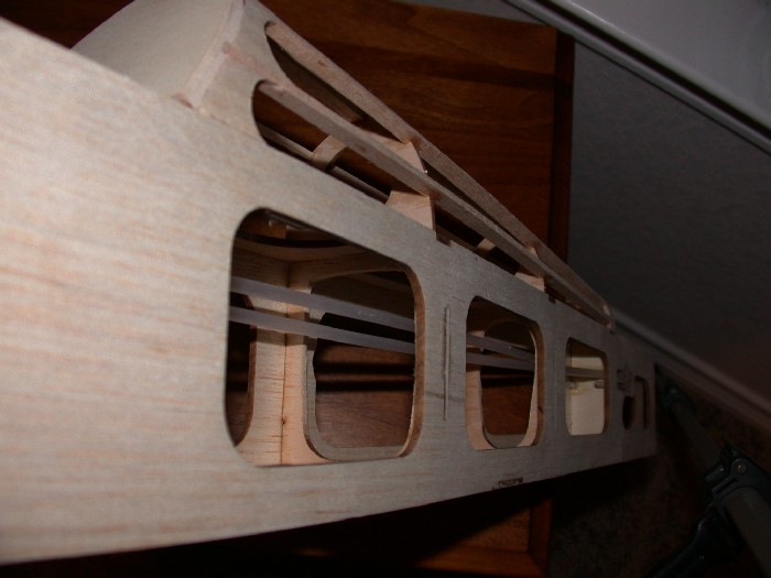

Originally posted by Flying Scotsman
I look forward to JWN's pictures of the pull - pull system for the rudder as that is what I would like to do with mine.
Steven,
Here ya go. Please excuse the sloppy glue. I didn't take too many cares in building this bird and got carried away at times
The tube exits will look MUCH better once I spread a little spackle (putty is your buddy!) over the exits and sand them smooth. One of the pics shows how I opened up the rear bulkheads to allow the cables free travel from the servo to the rear without guide tubes. I'm going to mount the rudder servo in the location shown on the plan for the throttle. This will move the output wheel closer to the center of the fuse. It's not perfect, but definately adequate. The elevator will sit on the left side and throttle on the right. I will raise the rudder servo aprox. 1/4" to allow the cables to pass over the other two servos. The cables will cross from below the elevator pushrods to above on the outside of the pushrods.
John
