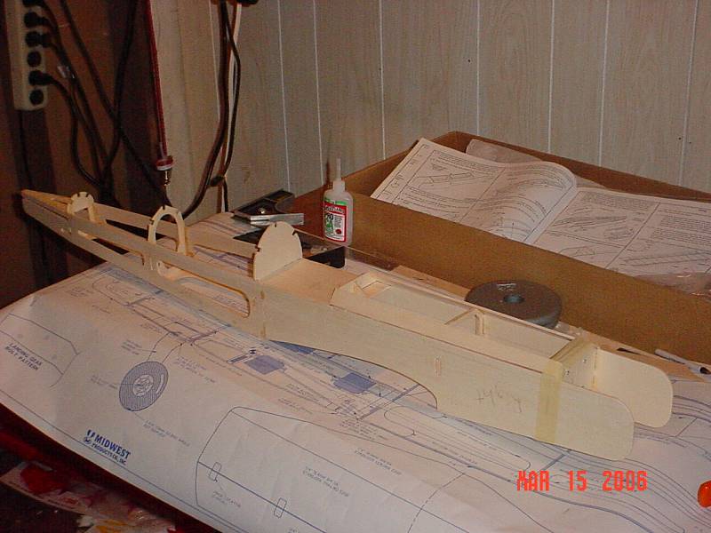

I started the star duster today. I got about 3/4 don with the fuse assmebly. While assembling the horiz. stabilizer I noticed that there is a good bow. About 1/8 in while lying on a level surface. I dont know if I should use this or make new ones. I have the stabilizer on a flat surface now with wieght on it but when the wait is removed the bow pops back up. Besides that the kit is going together smoothly.

Old 03-15-2006 | 11:00 PM
w8ye's Avatar
My Feedback: (16)
Posts: 37,576
Received 11 Likes on 10 Posts
From: Shelby, OH
Default RE: Midwest Star Duster
Wet the concave side and weight it down a couple days.
You may have to start over on that one.
Enjoy,
Jim

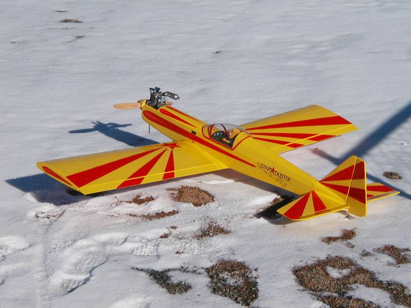

Here are a couple of pics, first time trying to up load.
Old bird, over and out.

Old 03-16-2006 | 12:23 PM
Joined: Jan 2006
Posts: 187
From: Gilbert , MN
Old Bird
I hope mine turns out as well as yours did. Looks real nice, I like your color sceem. I cut some new pieces for the horz. stab.

Old 03-17-2006 | 01:09 AM
Joined: Nov 2003
Posts: 213
From: Reno, NV
Mike B, Looking good on your build. After looking at the pictures, I remember that after the build that I should have sheeted one more rib bay of the leading edge of the wing. That is because when I carry a plane to the flight line, I always grasp the plane by the leading edge of the left wing near the fuselage, and the fuselage just ahead of the tail surfaces. I am right-handed. I was always afraid that I would damage the wing when carrying it out to the flight line, but I never did.
Thanks for the kind words on the covering job, it was our first attempt at something more than basic. The bottom of the wing was covered in 2" checker board, red and white. I was trying to make it look something like the picture on the box.
Keep us posted on the build and flying, I really liked this plane, and still kicking myself in the a__ for dumb-thumbing it into the ground.

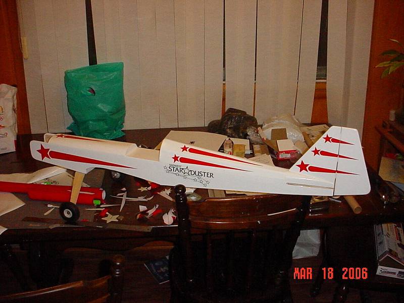

Some more progress on the Star Duster. The fine isn't mounted yet, but it looked so good I had to put it in for the picture. I decided not to sheet the wing. It seems pretty strong with out.

Old 03-19-2006 | 03:37 AM
Joined: Nov 2003
Posts: 213
From: Reno, NV
Looks real good Mike, lots of progress in a few days. The wing IMHO is plenty strong as is, except as noted in a previous post.

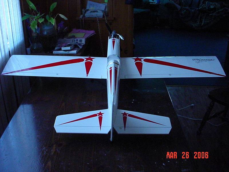

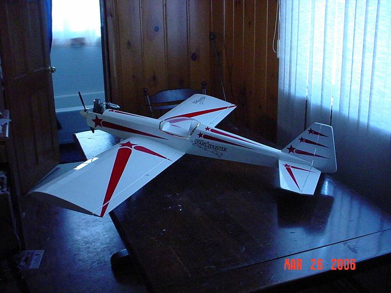

Well here she is my finished Midwest Star Duster. Turned up pretty nice I think. One of my better covering jobs, still getting the hang of it even after several planes. I used 21st Century film as the base and Goldberg Ultracoat for trim. Boy do I hate that Goldberg stuff, thank goodness I almost have it all used up. I saw a box of the stuff at the hobby store and the price was $5.99 a roll. Thinking that it was the Ultracoat that I had heard such good things about I picked up 4 rolls. Mistake, this stuf is junk. I was real happy with the 21st Centruy stuff though. Any way as soon as we have some grass showing the Duster will be in the air. Here are some pics.

Old 03-27-2006 | 05:01 PM
Joined: Nov 2003
Posts: 213
From: Reno, NV
Mike, nice covering job. Give us a flight report after the maiden voyage. I still miss my Starduster, we have a SIG 4-star kit in the building line-up.
