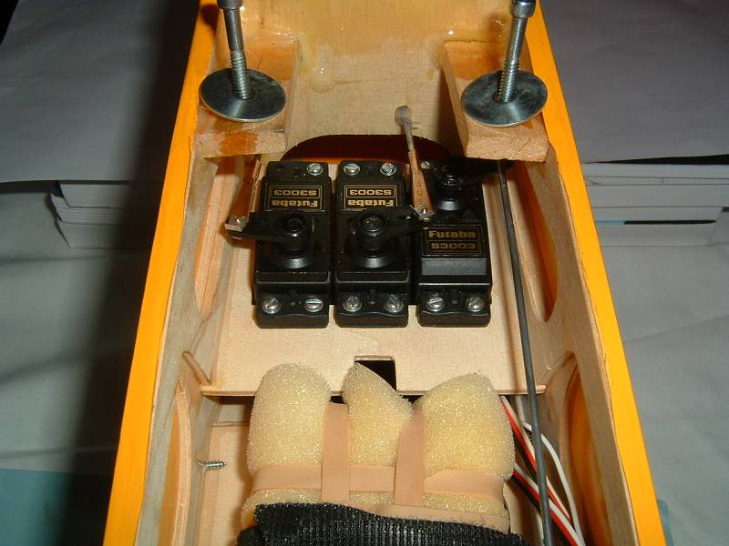

Ok.. I am the point now where I have everything covered except the fuselage. I am reading the instructions on how to finish up the plane and it recommends covering the fuselage before installing the three servos mount. I am finding this a little hard to accept. How in the world would I be able to get into it and adjust everyting. Since I have the alleron servo mounted in the middle of the wing that take up most of the area there. So I have to go to the compartment aft of the wing right?
Suggestions?

Ok.. I am a visual person. Anybody who has a tiger 2....can you take a picture of how you mounted the servos? I can't figure it out... I must be getting the itch to get it finished....

Are you talking about the servos in the fuse? I don't think it matters as long as they line up with the push rods and don't bump or bind. Mine wouldn't be the same because I converted to a tail dragger and have dual ailerons. Maybe one of the other guys will help.
When mine did have a nose wheel I put the throttle servo on the carb throttle arm side of the fuse, the elevator in the middle and the rudder on the other side. I put the nose wheel clevis in the hole on the arm closest to the arm mounting screw and the rudder out farther. You don't want the nose wheel to move a lot especially on a trainer or the takeoffs will be squirrelly. You can put the servo output shafts to the front or rear of the plane or a combination of both whatever works the best and keeps them from hitting each other.

Here is the inside of my fuse. This is by no means the only way to do it. I like the solder clevises because it is a little neater and safer. I hope it helps some.
Mine is an ARF.

Yep - That's how they go...

Ok..I feel a little better now. I thought it was supposed to go that way but when I tried to put the three 3004 servos in the factory servo tray they didn't fit. Looks like I just need to trim it out a little bit.

By the looks of your receiver do you have two servos in the wings?

Whether it's 1 or 2, the aileron servo(s) do get mounted in the wing.
