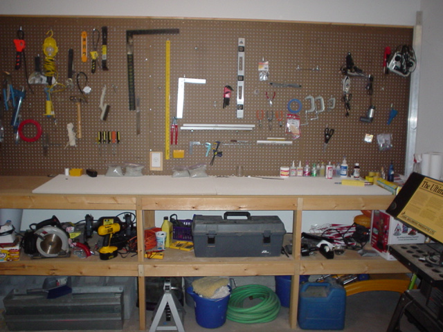

Well, I can probably give a pretty good perspective because I just built my shop up from scratch in the last few months.
In no particular order:
Lots of Great Planes Easy-Touch Sanding bars of all different lengths. (I have 3 of each. 80, 150, & 200 Grit sandpaper on each)
Dremel tool with cutting wheel & sanding drum
Weight bags ( I just use kitty litter in ziplocks)
several squares, small X-Acto ones are nice and larger ones for squaring the fuse & such.
several clamps and clothes pin's
I have a couple level's that are good straight edges.
Wax paper for covering your plans
Hobby-Lite wood filler
Thin, Medium, & Thick CA (and debonder) (read my Ultimate build thread for some good CA humor) [:@] http://www.rcuniverse.com/forum/fb.asp?m=3899491
CA accellerator
Micro saw
X-Acto file set
T-Pin's
Ceiling tile for building on
small drillbit set (i think it's made by X-Acto too)
Robart plane stand
Covering iron
heat gun
I'm sure there's more but that's what I can think of off of the top of my head. [sm=spinnyeyes.gif]
CA accellerator
Micro saw
X-Acto file set
T-Pin's
Robart plane stand
Covering iron
heat gun

I don't use accelerator a lot, but there are some areas that it's very handy. For example when I do sheeting I put down thick CA and then use a strait edge (level) to push the sheeting down & hit the top of the sheeting with accelerator. It soaks through the wood & instantly cures the CA. No clamps necessary.
yeah, i meant to say razor saw. :-) The copper box is a miter box that came with my saw. it's nice for cutting perfect 90 degree angles.
I probably bought half of my stuff from the LHS & half from towerhobbies. Most of these things are under 10 bucks so I won't buy it from tower unless I have a larger order that I'm placing.
One thing I just thought of. If I were starting from scratch again I would consider a magnetic building system. I haven't used it, but I'm thinking about switching over. RCKen describes it in his PIF thread. http://www.rcuniverse.com/forum/fb.asp?m=3439731
