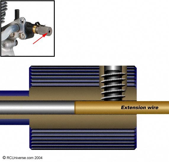

I'm not sure exactly how you are attaching allen-head bolts to your needles, but I'll have to go home and check the engine. More than one suggested it, so there must be some way to do it short of spot welding...

Here's how:
