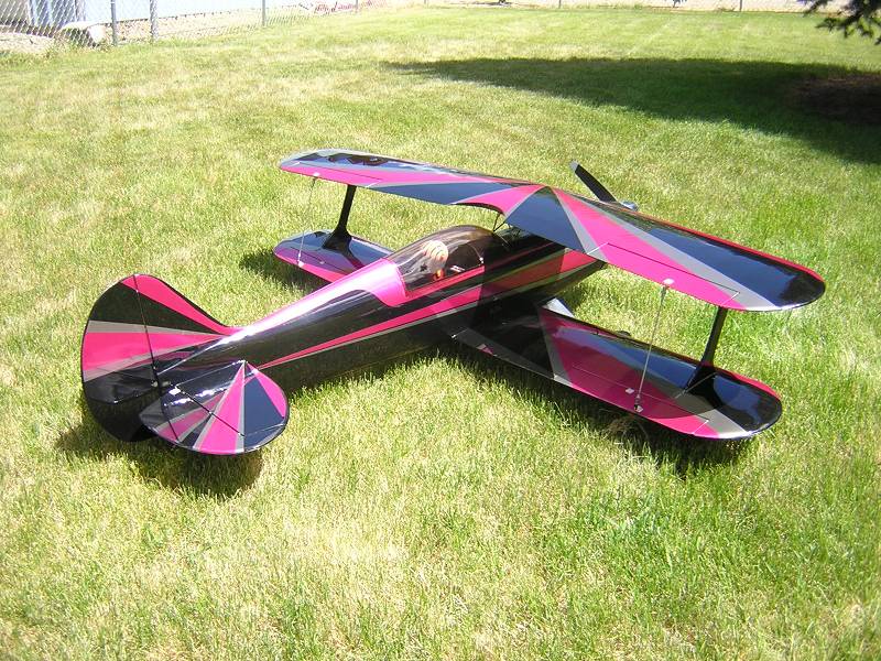

The Skybolt was my second kit. The only real pain was the center strut with regards to incidence. I recall no mistakes in the build.

That's an AWESOME covering job!!! Mind sharing some of the details?

Thanks! Monokote black, platinum and metallic wine. Wing panels were done off the plane. I applied the platinum and wine with trim solvent. It took a looooong time.
