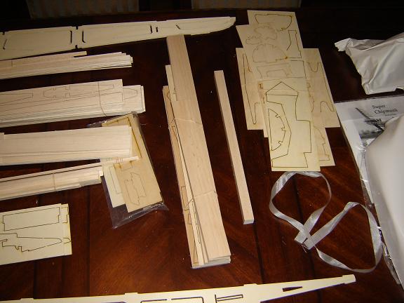

I have not seen a build thread for the CG Super Chipmunk so I thought I'd start one with my build. It seems to me that it has always been a very popular sport kit so hopefully lots of people can benefit from this.
I built this kit for the first time in 1992, if I remember correctly. I say built, but by "built" I mean mostly built. I finished most of the plane except for the vertical stab fairings, final assembly, covering (I covered the wing only) and equipment installation. I was about 12 or 13 and lost interest and my father sold all of my R/C equipment when he noticed it just sat around and did nothing.
Well, I've gotten back into the hobby and am about to finish my BTE Flyin' King. I was an excellent pilot as a kid (or I think so hehe), so I figure while I'm relearning how to fly on my FK I could start building my Chippy. I won't be in any hurry to finish the plane so if this thread drags on from weeks into months don't be surprised.
My primary goal with this thread is to post my build as I go and to hopefully provide lots of information for future builders of this kit. Of course I am also hoping to receive lots of input and suggestions because I do plan on modifying this plane quite a bit.
My goal with this kit is simple: best performance and reliability possible. To this end, here are my current plans for the kit, based on some input in another thread and research I have done. ANY and ALL critiques and recommendations are not only welcome, but desired!
Preliminary thoughts:
Inverted Saito .91 for the powerplant with a Slimline pitts
JR 9303 for the TX. I was thinking about using JR811 digital servos but was thinking I might be able to use mini servos and save some weight and power drain.
I'm not sure whether I'll use NiCd or NiMH. LiPo and LiOn were not recommended for this application, though I've yet to really see why.
I'm not sure what linkages I'd like to use. Maybe some DuBro ball links, though I'm not sure which. Any better recommendations here?
Pull-pull on the rudder, though not sure which pull-pull set up to use. DuBro again?
I'm going to round out the bottom of the fuselage a bit. My idea was to put some balsa triangle stock on the inner bottom edges and sand everything to a nice rounded shape. My biggest concern was strength. Would I need to reinforce the balsa?
I was going to add about an inch to the length of the rudder.
I don't remember if the elevator will clear the rudder or if the throw is limited by the rudder. I'll find out in the next couple of days.
Replace landing gear blocks with hardwood. Not sure what I'll replace the gear itself with though.
Fiberglass cowl and wheel pants from Fiberglass Specialities.
Replace the bottom ABS wing fairing with a built-up balsa fairing.
Add a Sig Epoxolite fairing on the top of the wing.
2" carbon fiber spinner, or aluminum if I am doing well on weight
Any and all possible lightening to the structure without sacrificing strength. I remember there being an awful lot of areas in my first kit that I thought were overdone, so I'm guessing that hasn't changed.
I would like to keep the AUW to 7lbs or less.
Anyway, that's the list of stuff off the top of my head.
Alright, let's get started!
I received the kit from Tower Hobbies (I wish Horizon had a larger selection... but it's hard to beat some of the great coupons Tower has) Wednesday afternoon. I came home from work on my lunch break to make sure nothing was damaged. The kit box, along with a few other items I'd ordered for my FK, were packaged in a significantly larger box with a good number of airbags for protection. The outside box sustained some damage but the kit box was in perfect shape.
I seem to remember the box from the 90s being white and a bit smaller, though I could be badly mistaken. The paper label with the kit details seems to be precisely the same.
Upon opening the box you can see that the packing is quite good. All the parts are laser cut now too. I remember them being die-cut and I absolutely hated that. The burning doesn't seem bad at all either. Some very light sanding with 600 grit sandpaper should be more than sufficient to get the carbon off.
I don't have any pictures of the parts yet as I haven't yet taken any out of the box. When I go through and sort everything I will post more pictures.
That's it for now; I'll post more tomorrow!

If my allergies will let up I'll pull everything out of the box tonight and get more pictures. I am exhausted from work so do not think I'll be working on either my FK or my Chippy tonight. If I weren't so busy at work this week I could have had the FK in the air by Sunday too.
