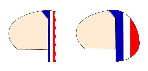

WARNING. The ELDER 20 as built by the plans is virtually un controllable!!!
The rudder is waaaayyyy toooo small! May I suggest you DOUBLE the size by making it twice as wide as called for on the plans, then add a square as tall as the rudder is wide to the top of the rudder? Then it might turn in a reasonable manner.

I built one of these back when they first came out. It wasn't an aerobat, but it flew okay, about like my 3-channel Goldberg Eaglet. Very slow with an O.S. 20 FP--I could land it straight down in a 15mph breeze. I added a tailwheel so I could taxi. It needed a long take-off roll--possibly due to the forward-mounted landing gear--but I don't remember any other ground handling problems. In the air it was not terribly responsive, wouldn't do any tricks, but it was stable enough and it looked great. Hardly uncontrollable.

thats kind of what I was expecting, i'm building this to look cool at my clubs fun fly not to do stunts but major tom's post has me concerned. thanks

I've seen one of these built with a filled-out rudder, a big rounded job as opposed to the scalloped flap that it comes with. Looked good and no doubt gave it a lot more authority.

Didn't mean to scare you off. It just needs a lot more rudder to fly well. The stock rudder makes it handle a lot like a parkzone J-3, add rudder and wait, and wait and... you get the idea. More rudder will help it turn when you command it to.
