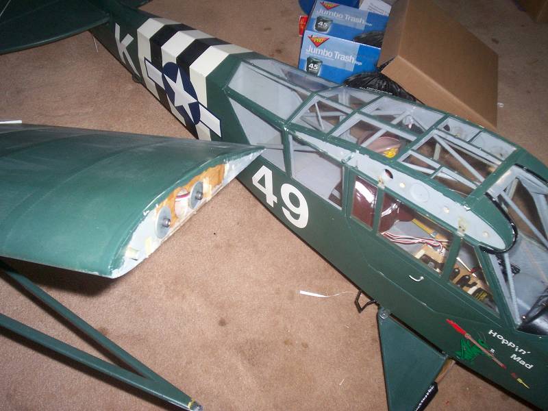

That would be my vote, too. I have one, an awesome plane to fly, and an equally awesome kit, all laser cut, functional wing struts, great scale detail. The wing center section is part of the fuselage, and the wing halves slide on to a wing tube and have a screw inside the cabin, plus the strut mount. Each wing half is 40 inches, and the fuse is 55-1/2 inches long from prop nut to tail. The horizontal tail is 24 inches wide. The Great Planes 40- size floats would be just about perfect for it. With floats, a .65-.72 4 stroke would be perfect also.
I don't have floats on my Sig, but I modified mine and it weighs about 11 pounds, and I fly the heck out of it with a .65 Saito. I also have a Hangar 9 Cub ARF, just a tiny bit smaller (80 inch wing vs. the Sig's 84.5 inch) and I have the GP floats on the H-9 Cub, it weighs 11 pounds also and it has a ton of power with a .72 Saito. Both are plenty big, look great and perform well.
The next larger Cub with 2-piece wing is the 1/4 scale BUSA kit, each wing half is going to be about 50 inches, and the fuse will be about 65-66 inches, plus it will take something in the 1.20 or larger range to fly it with floats (G-26 would be nice, too). The Sig 1/4 scale Cub has a two piece wing, but the wing halves are different lengths. The center section is part of one wing half, and it bolts on like a one-piece wing.
Here's how the wing attach looks on the Sig 1/5 scale, minus the wing tube, but you can see the hole where the tube went. I omitted it in my L-4 conversion for aesthetic and scale reasons.
