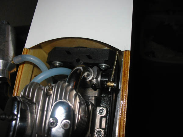

the saito carbs are reversable so you can have the throttle arm on either side. I put mine on the left side.
This is my 4 star 60 with a saito .91

you can use some solder on the cable end to keep it from fraying and to give it some rigidity

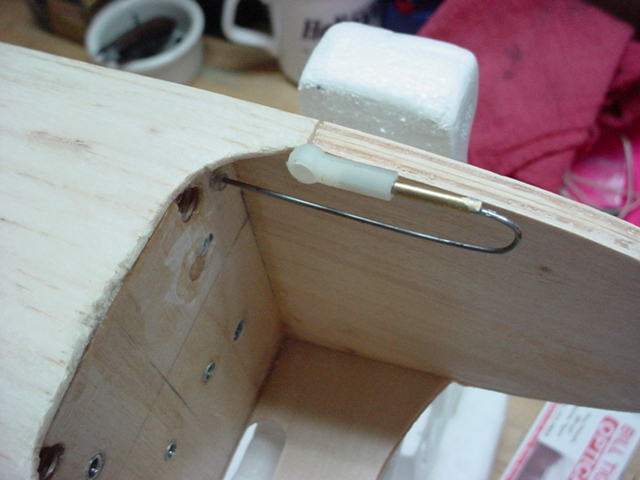

The bellcrank arrangement is nice, but adds weight and complexity, aside from needing plenty of room between the mount arm and the cowl side.
A better, easier way is a simple wire with a 180 degree loop. This gives you more flexibility on exit points, and provides a sort of built-in servo saver.
Sorry for the lack of detail in the pic, but I'm in the sanding phase, and I wasn't about to mount the engine just for one lousy photo...<G>
