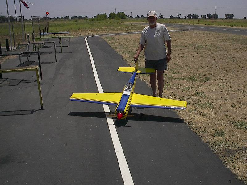

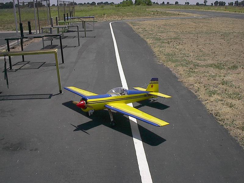

This was the first time I have taken A maiden flight and only had to do one little thing, I needed three beeps of down in the elevator. The Sukhoi takes itself off and has no pull to the left at all, just point and go. When I checked the stall it hasn't any?? Just rocks the wings and decends. The only thing I see I will have to work on is it wants to pull towards the gear when in knife edge so I will have to do A little mixing. Wish all maidens were this uneventful, my hands and knees didn't even shake, I did sweat, it was 108 at the field today.

Chuck, my Suk was built from plans that I bought from MAN and redrew and designed so I could go with A gas engine. It is an 80 incher with A Brison 2.4 40cc engine. The reason I posted here was I always make up my own kit first then build the plane, it's very easy and nothing more then kit building, just making up ribs and formers is all, A short kit if you will.
Carl Goldberg makes A great Sukhoi 26 kit and around four pages back you will find A thread posted by Huges500E that ran for A long time. A big bunch of the guys built the kit at the same time and I followed there builds and made any changes that I saw them doing that sounded good, Huges {I think} even sent me A copy of the kits dash board that I have in mine.
Most the guys have maidened there planes now and it looks like they were all good flying planes, in my case it went beyond good and was A great surprise for me.
When speaking of an ARF and A kit it can sometimes be apples and oranges. If all the incidences were correct and the plane is ballanced then the Suk. shouldn't be A snapping machine like A lot of the CAPs I have seen, if it snaps your going too slow, mine just rocks the wings like my Extra and lets me know I'm too slow.
Talk to John L-W at your club and he can help you with getting it to fly right. The Fresberg club has some of the better pilots and they can be A great help getting A plane set up.

Graybeard, I've got one of these that I bought already framed up. It was built with contest grade balsa with the intention of having a light setup with a 90 fourstroke on it. I put a an MDS 1.48 on and it balanced perfect and weighed just a hair over 11 lbs. Best flying plane ever.
After a few wrecks and some mods (fiberglass cowl, rear mounted elevator servos, antivibration mount) its at around 13 lbs and although still flies nice it could use more power.
Yours looks GREAT!

Thank you much!! The plans were from MAN and designed by Mark Sirianni. It was designed to come in at 10 pounds. My first thought was my YS 110 but due to the size I decided to just redraw everything and stuff A gas engine on it. Even the way I did things it was A light plane until I installed the engine and two batteries. I used the LG from A Wild Hare 27% Extra. It had enough ground clearence for the 20 inch prop if the pilot knew how to land smoother. After the first landing I changed over to an 18 incher and all is now well. I could go back to the 20 after A couple of tries, took no time at all to get used to this plane.
My cowl is all one piece built onto the fuse but the top half comes off for engine work. I liked the way Mark designed it so I made no changes except how to mount the top part of the cowl.
This was A very easy build and came out looking good with the round fuse. Looking back there are A couple of little things I would do different but not much. If anyone wants to go bigger and try building from plans this is one of the good ones.
