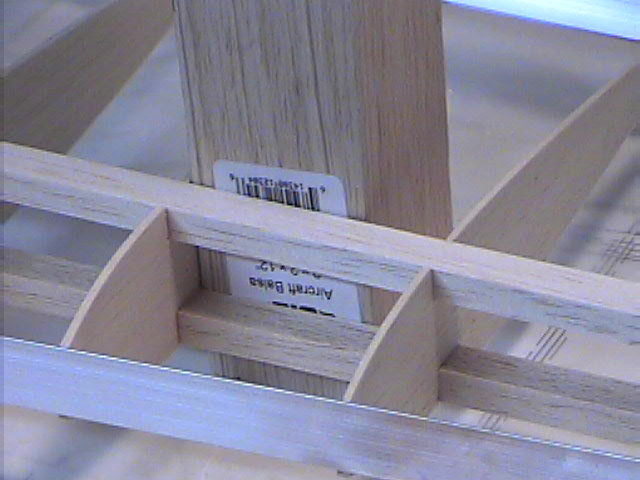

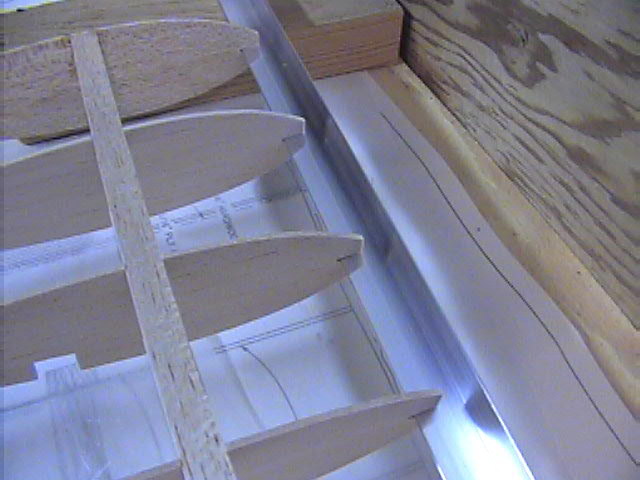

I just got my utter chaos for Christmas and I Think its going to be a good one. Instructions are a little hard to understand. I built a wing jig out of 1/16 3/4 angle made the wing easy to build. could send pic if you like. The wing ribs have a notch in front and back that the angle slides into. I am looking forward to getting it flying. will be flying SPA pattern this spring with it. Gary

Gary,
Can you post a picture or two of you wing jig?

OK here are some pic just use 1/16 3/4 angle and some scrap 2x4s I have a plywood work bench so I just screwed it to the bench. Gary

another pic
