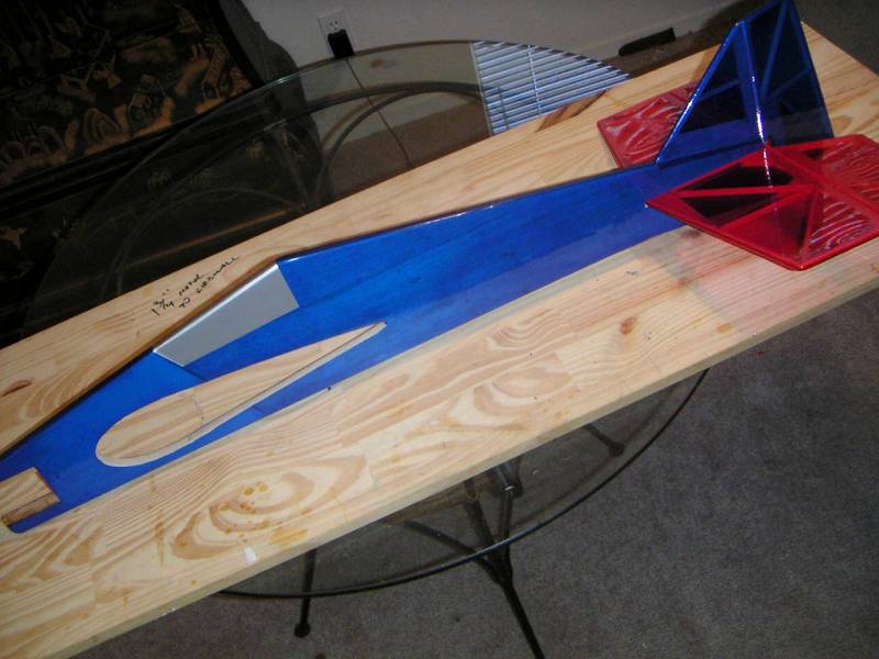

Maybe this should be in the profile section but I figure it's a kit so I'll post it here. I should have gotten some pictures a lot earlier in the build but better late than never. Has anyone had any experience building or flying this kit? Any recomendations? so far, it's been an easy build other than where I've had to work on it. As you can see, my working conditions aren't exactly great at the moment; I'm in temporary quarters until we get into our new house next week. Then I'll finally have a nice workspace again.

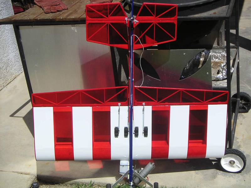

Hi, I done this kit.

Build it per the instructions.
Use 3-D type control throws.
Don't underpower it.
This plane has a very low speed envelope. When it finally does stop flying, you have nothing left. That's the only caution I can think of. It's a great plane and you'll enjoy it a lot.

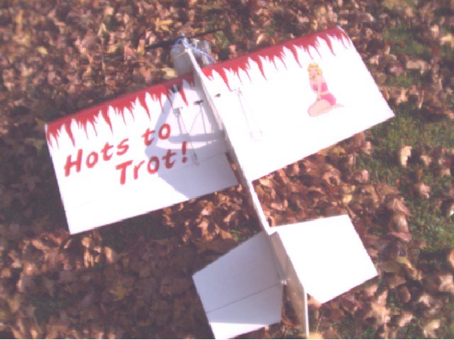

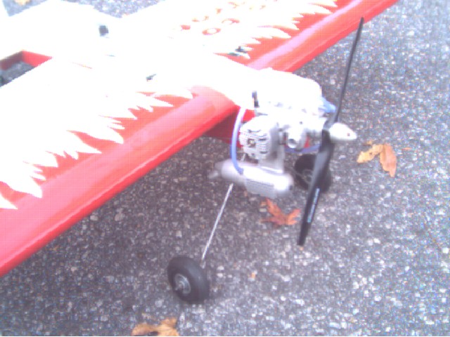

Dr.1

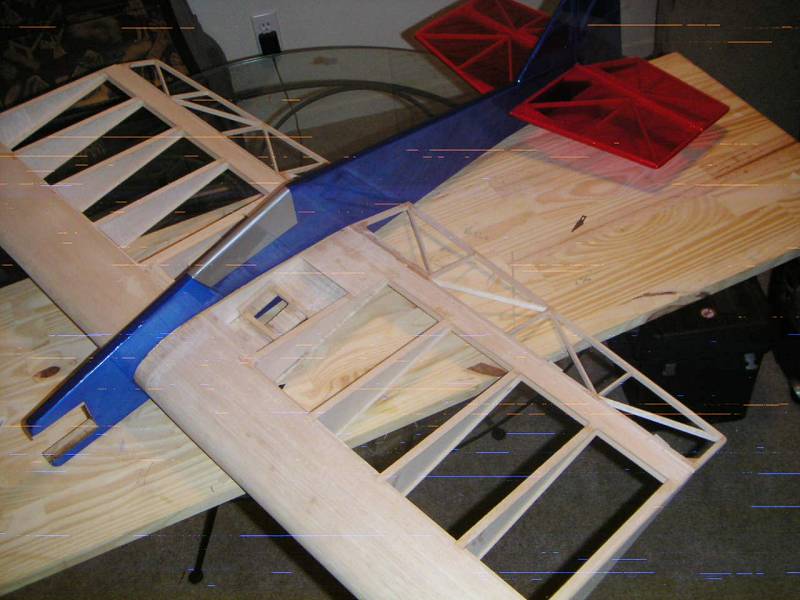

Old 07-05-2006 | 11:56 PM
ChuckW's Avatar
Joined: Jun 2006
Posts: 5,165
From: Clovis, CA
Default RE: Morris Profile Hots Kit
It's coming along nice. All that's left is covering of the wing & ailerons , mounting the engine & radio equipment, fuel tank and landing gear. I'm moving over the next few days though so progress may get put on hold temporarily. From the looks of the picture, it may be time for a new digital camera too.

How is the fuse built? Is it stick built with balsa sheeting on each side or lite ply? Just curious.

The fuse is built out of some laser cut parts and balsa stick. Then it's sheeted with thing ply in the front and 1/16 balsa in the rear. I'll get back to work on this soon.

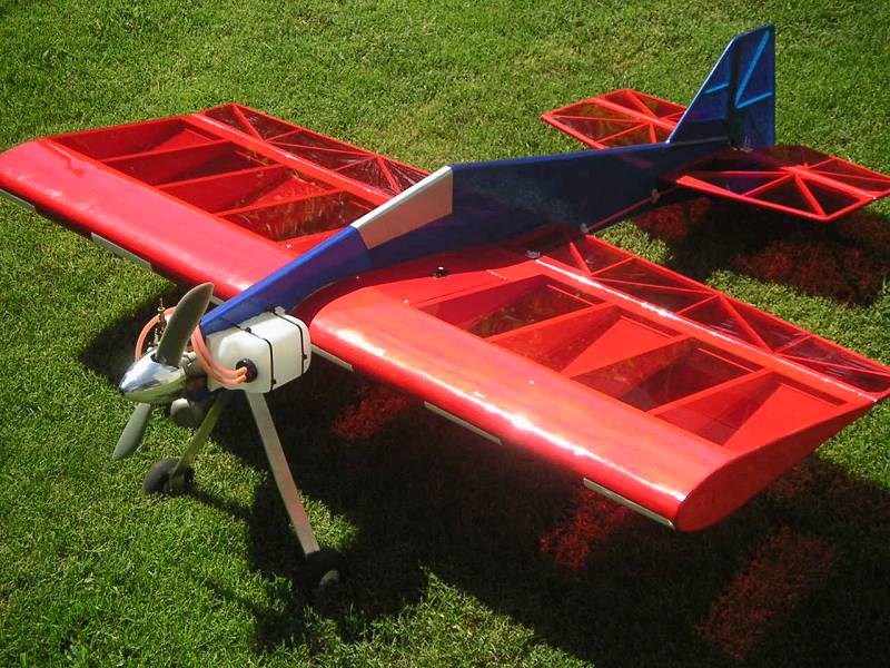

It's finally done. Got everything dialed in and fired up the Super Tigre .51 this afternoon. It's not the best job I've ever done... the covering is simple and some stuff isn't as clean as it could be but it will hopefully be fun anyhow.

Well, I couldn't wait for the weekend. I took the profile Hots out yesterday evening before the sun went down and got it into the air. I was supprised at how well it handled on the ground. The take off roll was short, it almost jumped into the air. It needed a little aileron trim but that was it. I didn't get too wild but the roll rate was very fast and overall handling was great. Landing was also very easy. It floated right in for a soft smooth touch down almost right in front of me. I think I will keep this one.
