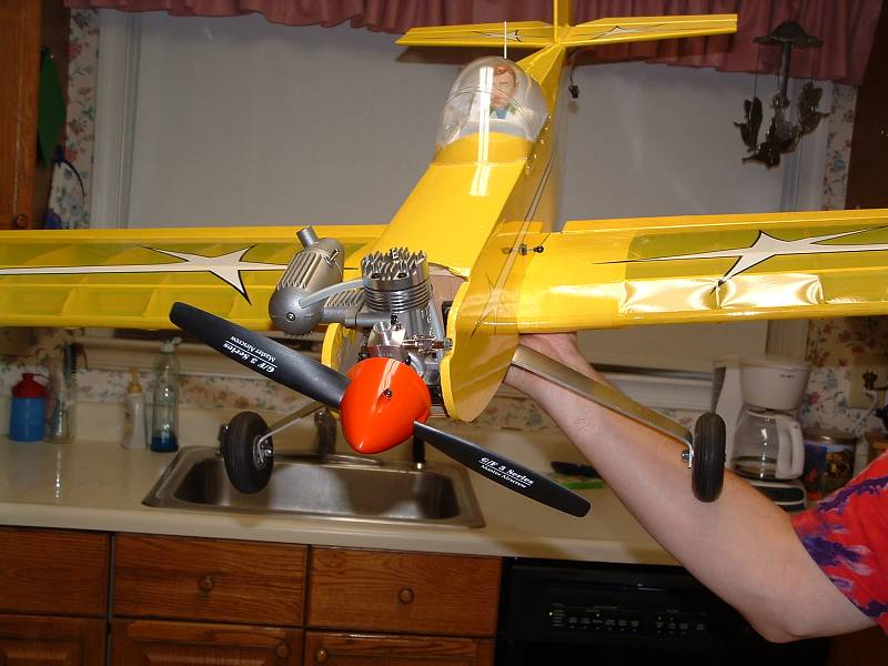

Joined: Jul 2004
Posts: 579
From: Cape Town, SOUTH AFRICA
Maidened my four star 40 yesterday.
I sheeted the wing from the LE to the main spar, this added alot of additional strength and IMO improved the aethetics of the wing LE.
I have a Saito 56 in mine with an APC 12x6 prop pulls really nicely and I love the sound of the engine.
If I was to build another 4* I would do the wing mod again.
Posts: 931
From: Great Falls, MT
That looks real nice Andrew.
FWIW, I built mine stock and it has survived many violent snaps and hard landings. I have put the wheels into the wings a few times. I had my youngest on the buddy box and was showing him how to do snap rolls. I do them on an upline and he forgot this part and did it from full throttle at level flight, no problem.
I would ca the wing mounting dowel and hole to beef that up a bit. After MANY flights, mine got a little loose. I do this to all my planes now.
Mine has flown with Magnum 52 4st, ST51, TT46, Saito 82, OS55AX, Saito 45. Flies better lighter, still flies good with the heavier engines. The Saito 45 is off to make room for a Saito 65. The battery will need to be moved back to keep a good balance point.
Mine flew a few years at the suggested cg just fine. I started moving things around to get the cg back further. Much better!
