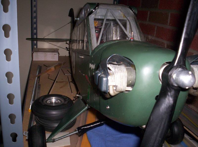

Here's a few quick ones of the dummy I scratched for my 1/5 Sig. Cylinders are cardboard tubes from a MonoKote roll, heads are balsa blocks, fins were cut into them with a hacksaw blade. the eyebrow scoop and valve covers were cut from the dummy engine included in the kit. I can make more pics if you'd like.

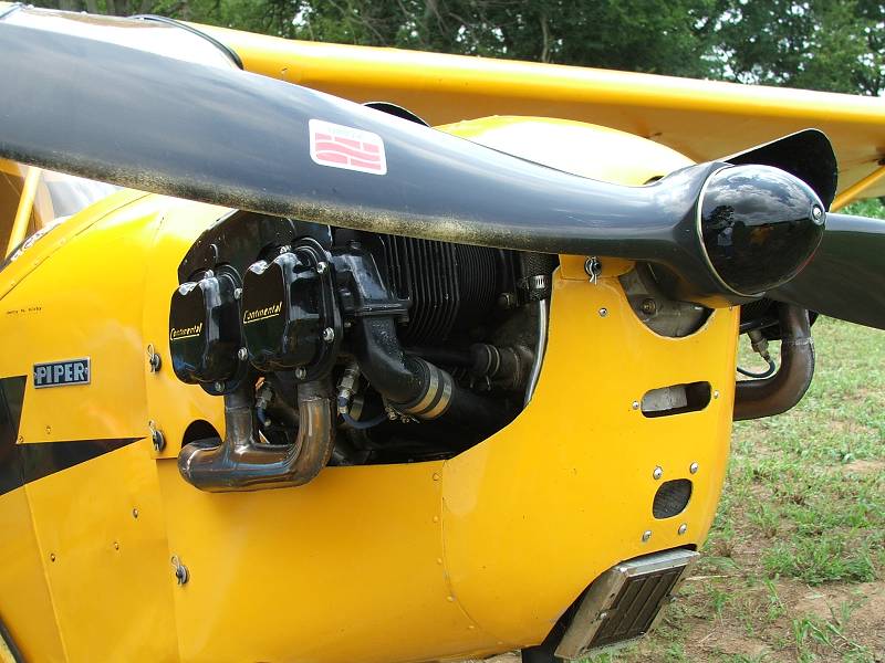

Here's a pic of the real thing...Working on a quarter scale Cub myself.This one landed at the air field and I took the liberty to take as many photos as possible! Hopr it helps with your prodject.
Ray

Thanks for the pictures! Now I have something to start from.
This is the first RC stick I build; it has been the hardest one, but olso the most interesting. The difficultest part has been the fuse! I'm building it with operating door and window. Now, I'll be able to scratch build the dummy engine.
