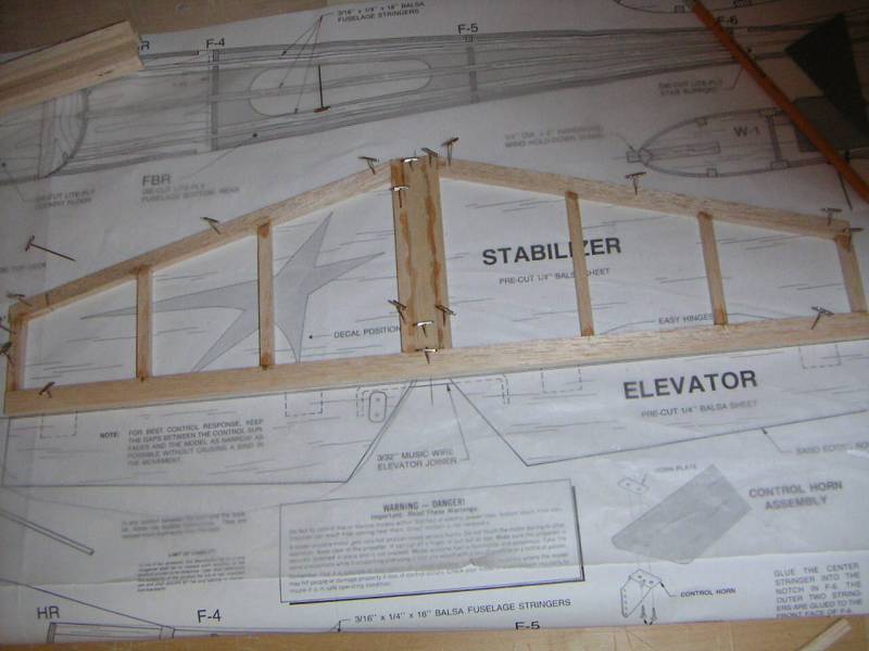

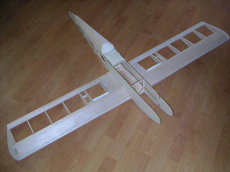

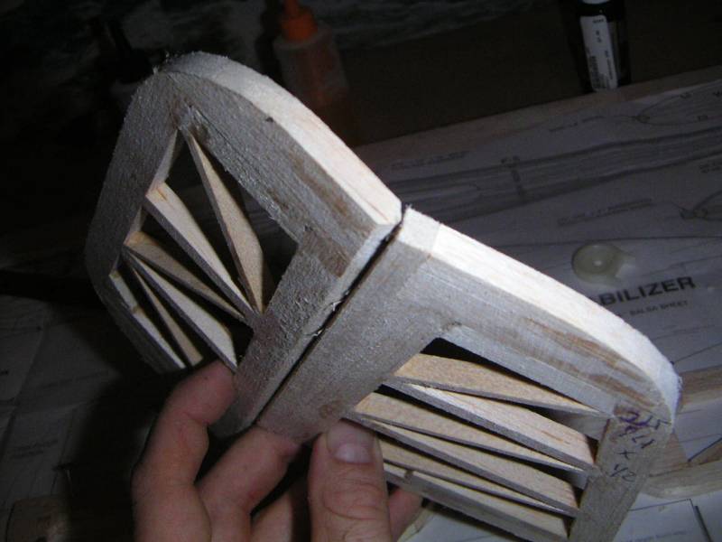

I Just finished up my Somthin Extra and I haven't even had it in the air yet and I already have the urge to build something else. I had a 4* kit in the closet so I decided to get going on it. I figured I'd post progress on here since this plane gets a lot of questions from beginners. I've built 2 4*'s in the past. The first plane crashed and taught me 2 valuable lessons: the first is to be careful when checking your CG and the second is to never fly in the fog, not even light fog. The second plane had a longer lifespan, I flew it for a few months and sold it. The 4* is a good airplane but there are a few things I don't like about it such as the ugly canopy, odd nose shape, flexible wing with no sheeting, etc. I decided to correct those things and others in this build.
I started with the wing. I know the stock 4* wing is light, easy to build and works well when built straight. I just don't like something so flexible that I can warp it just by shrinking the covering. For this latest 4*, I decided to scratch build a wing with a D-tube construction and cap strips. I started by using a W-1 rib as a template and making the spar slots deeper. I eliminated all of the small sub-spars. I then cut a set of new ribs from this template. Since I was clipping the wing and using sheeting, I figured I could space the ribs at 4" rather than the 3" shown on the plans. Once the shear webs, sheeting and cap strips were installed, the wing is straight and rigid while still being light. I also made mounts to put the aileron servos in the wing. Once the other half is done, I'll come up with some sort of wing-tip shape.
This is the most that I have ever altered a kit so I hope that I don't regret it. There's only one way to find out.
ID:	522798   Click image for larger version

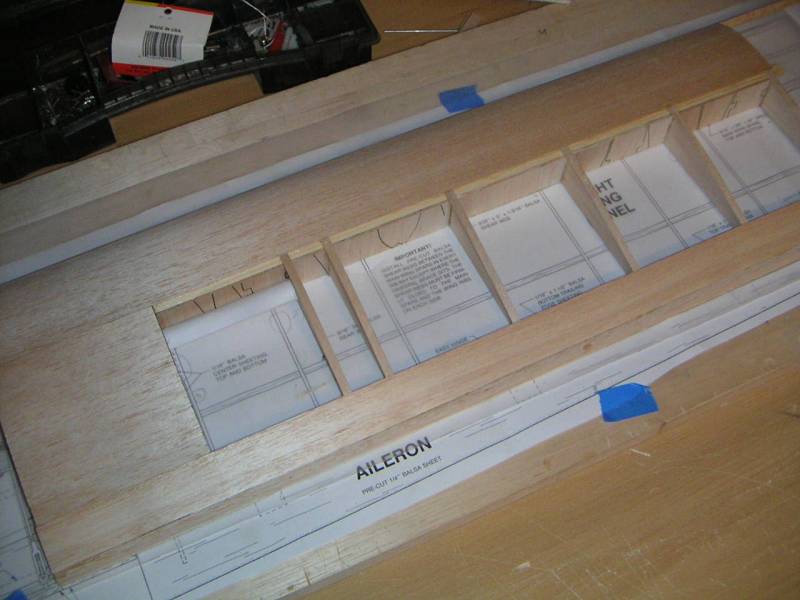

I'm going to reduce the dihedral angle by about 1/2 so I won't be using the stock ply wing joiner. I put shear webs on both sides of the spars between the first 2 ribs on the root end and cut an opening between the spars on the first rib. This creates a pocket for a wing joiner that is the full width of the spars. I'm not sure if I'm going to make the joiner from solid hardwood or laminate so light ply; we'll see.
I got home alittle early this afternoon so I finished the right wing. I built some wing tips and constructed the aileron from sticks. This aileron is 1/4" wider than stock, hopefully this will be an improvement rather than a problem.

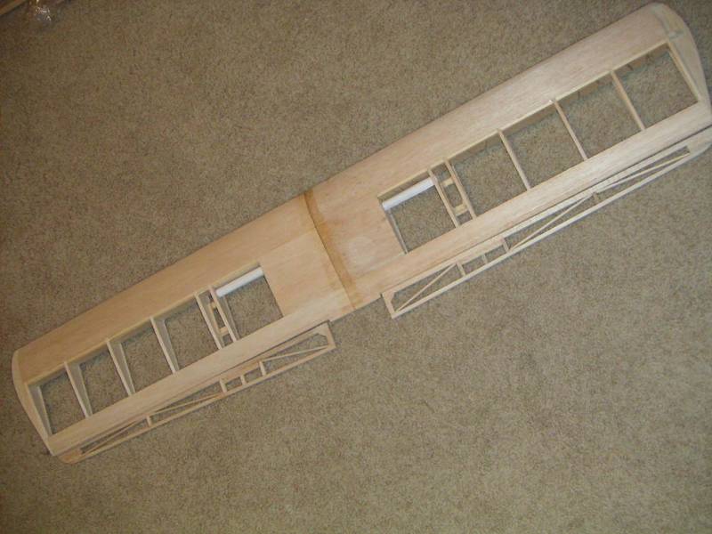

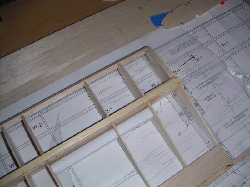

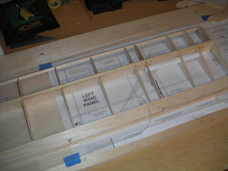

Tonight I had a little bit of time to start on the left wing half. The first thing to do is cut out all 9 ribs from 3/32" stock using the stock W-1 as a template. Then I placed them on some scrap spar material, pinned them together along with 2 W-1 ribs and sanded them so that they all match. On 3 of them I used a forstner bit to drill holes for the servo lead tube. From there it's just a matter of laying out the modified rib placement on the plans and building up the wing. I've included a couple shots that show the shear webs glued directly on the back side of the spars, rather than in the center as shown on the plans. Another shot shows the 1/4" balsa doubler I added to each root rib. This should make drilling the dowel jole a lot easier.
Old 09-13-2006 | 12:18 AM
ChuckW's Avatar
Joined: Jun 2006
Posts: 5,165
From: Clovis, CA
Default RE: Not another 4* 40...
Ok, the pictures should show up this time...
ID:	523282   Click image for larger version
ID:	523283   Click image for larger version

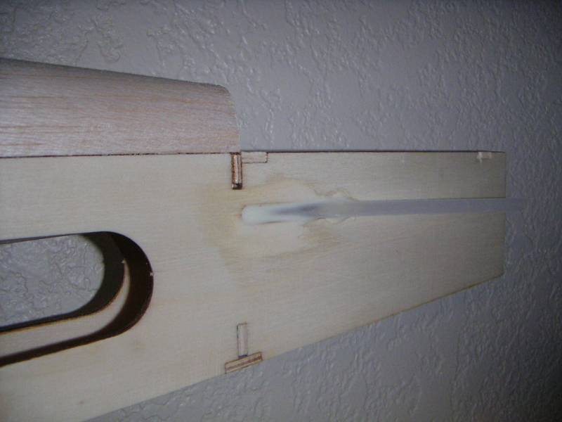

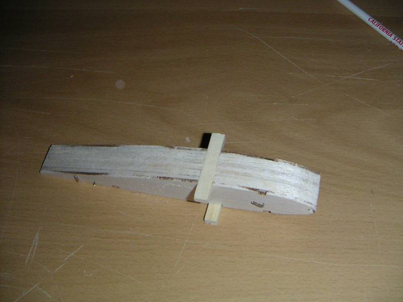

Here's the wing joiner that I was talking about. I'ts a lamination of plywood and balsa that comes out 3/8" in thickness and fits between the spars. I know the picture is blury but you should get the idea.

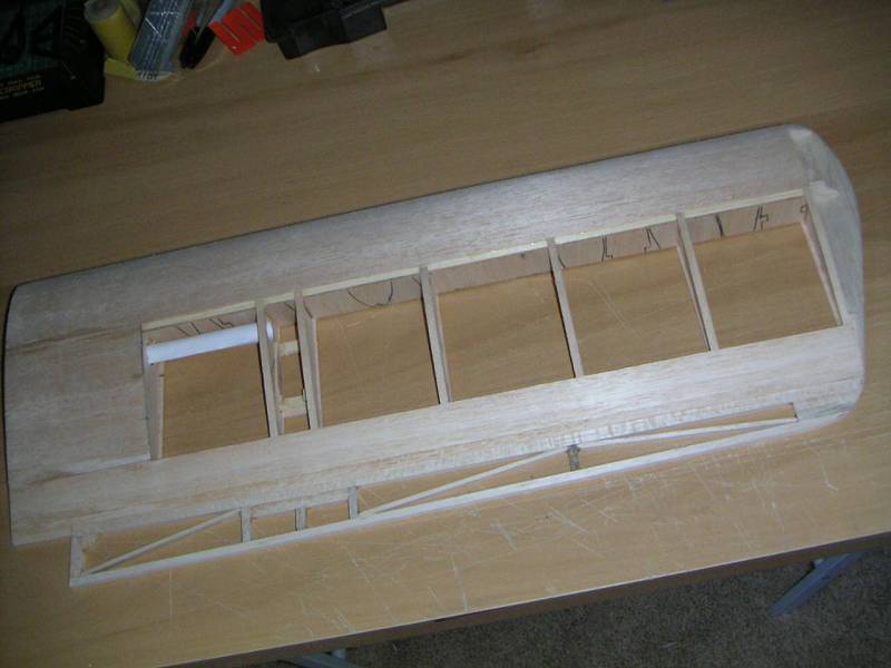

Here's the wing all finished except for bracing on the left wing tip and holes in the top sheeting for the servo leads. The only parts from the kit used in this wing were the basswood spars and the TE sheeting. The fuelage will be built more according to the plan, using the kit. The only deviation will be sheeting on the turtle deck and a cowl. Once I get to the horizontal and vertical stabilizers, I'll probably scratch build them too with a modified shape.

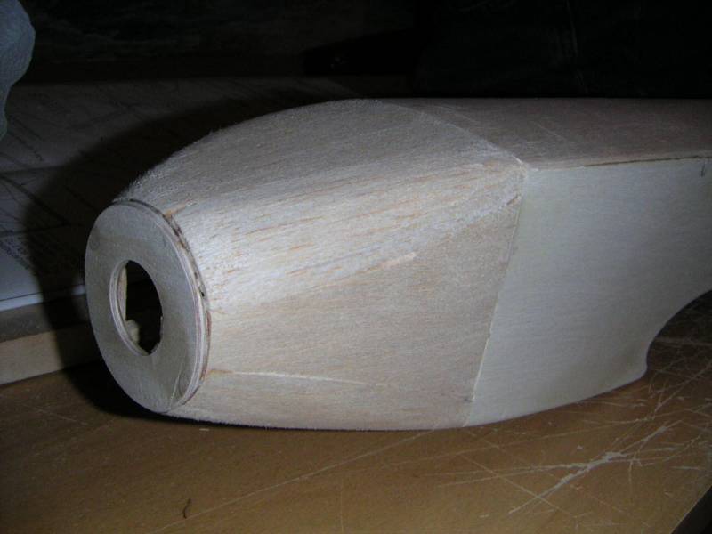

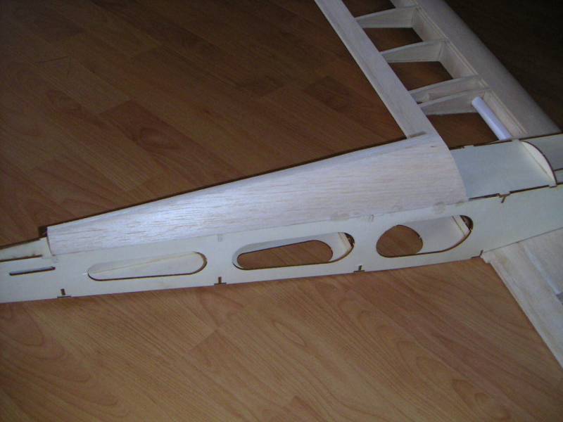

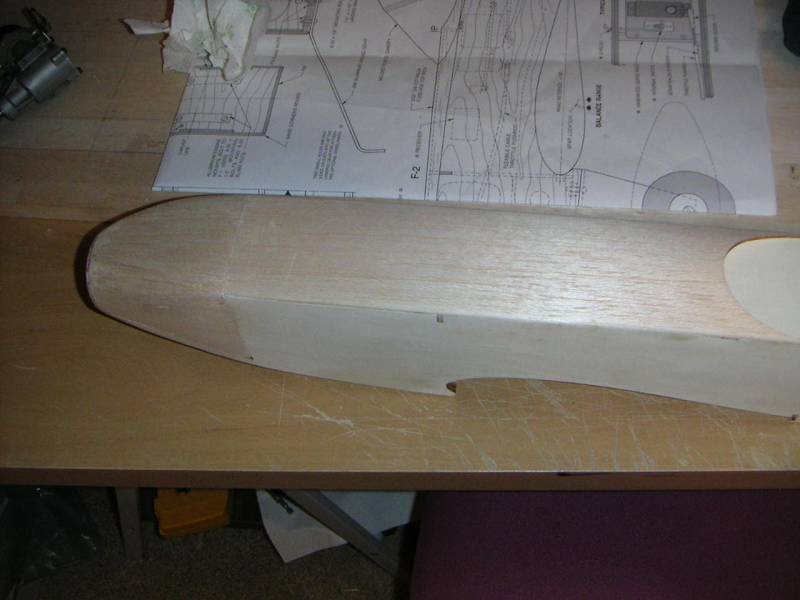

I've started work on the fuselage now. It basically builds itself so there isn't alot to say about it. In the pictures you can see the modified turtle deck. Not only is it sheeted, it is angled different than stock, making F-6 taller and allowing the use of tail fairings. I should have taken more photos of these modifications but I got so caught up in things that I forgot. Basically, I started by making the headrest 1/16" smaller then cutting the tops off F-4, F-5 and F-6. I drew my new deck angle on the plans and determined the new height for the formers. I made the modifed former tops from scrap ply and glued them on. I only used a single 3/16x1/4 stringer down the top-center of the turtle deck. Then it was just a matter of wetting the 1/16 sheeting, cutting it to fit and glueing it down. You can also see that I'm starting on the horizontal stabilizer (not done yet). The solid balsa stab included with the kit didn't match up with the plans. I also tend to think that solid pieces can warp more easily than built-up pieces so I decided to just scratch build the stabs. I'll be adding some sort of curved tips to compliment the ones on the wings.
ID:	525835   Click image for larger version
ID:	525836   Click image for larger version

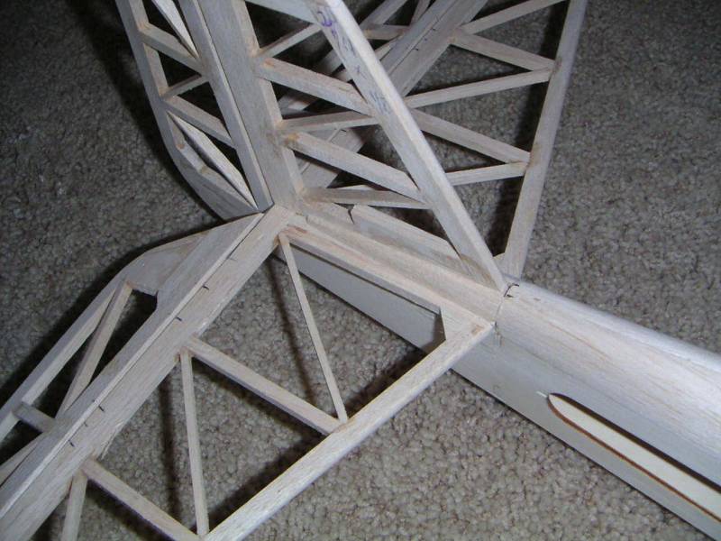

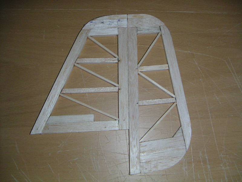

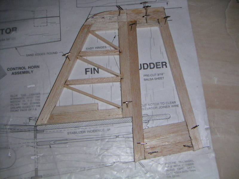

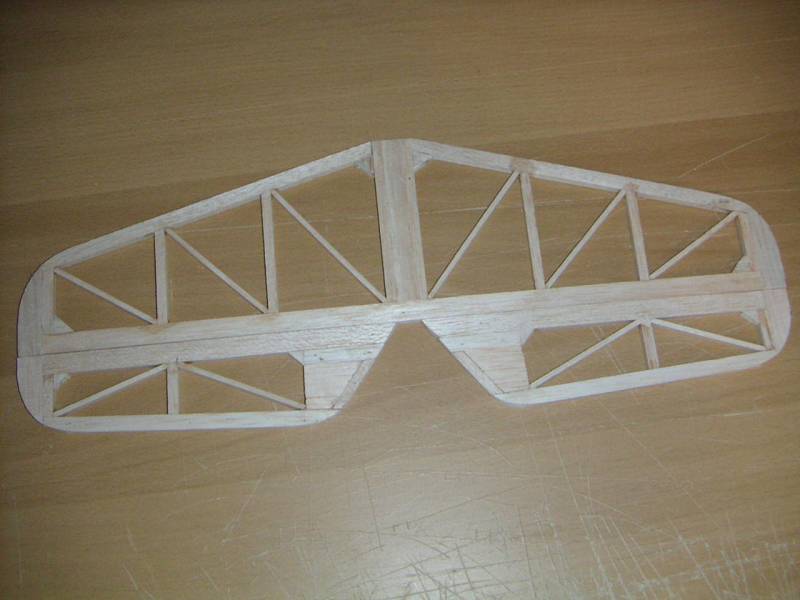

Tonight I got all of the tail section framed up. The horizontal stabilizer has a span 1.25" more than stock. The Elevator halves are 3/8" wider. The vertical stabilizer is 3/4" taller than stock. The rudder is 1/2" wider and the hinge line is angled back slightly. Hopefully these increases will make a great flying plane even better and won't make it too touchy. If it is, I guess I'll just have to reduce the throws and/or add a lot of exponential.
ID:	526607   Click image for larger version
ID:	526608   Click image for larger version

Here's a look at the tail section mocked up in place.
