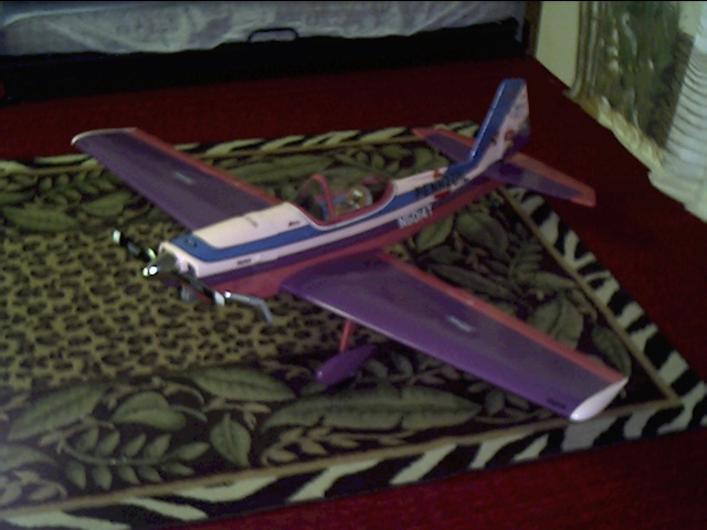

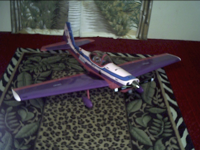

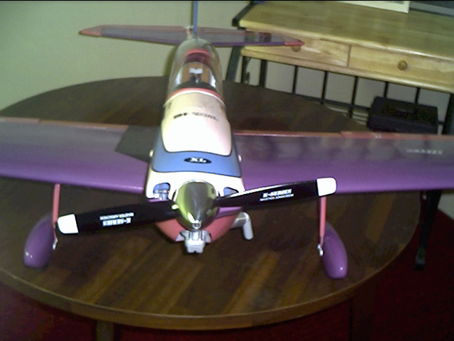

Here are some pic's

Looks Great!
Nice to see something other than red, white, yellow, or blue.
How's it fly?

It flys great. My 12 year old daughter came up with the color choices and the way it was painted. It's got Solartex fabric painted with Krylon primer and then three to four coats of all the colors. I then put all the stipping on it and decals and shot it with three coats of automotive clear coat. Waxed it three times and only added about 3/4 lb. It's a little on the heavy side but the 91 Magnum 4-stroke with a 14x8 does just great. I got sick of everybody painting theirs red white and blue. Mines definitly different and easy to see in the air.
