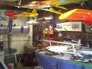

I build on my 10'x4' work bench in the garage when the weather is fit, and during the winter at my wifes kitchen table.

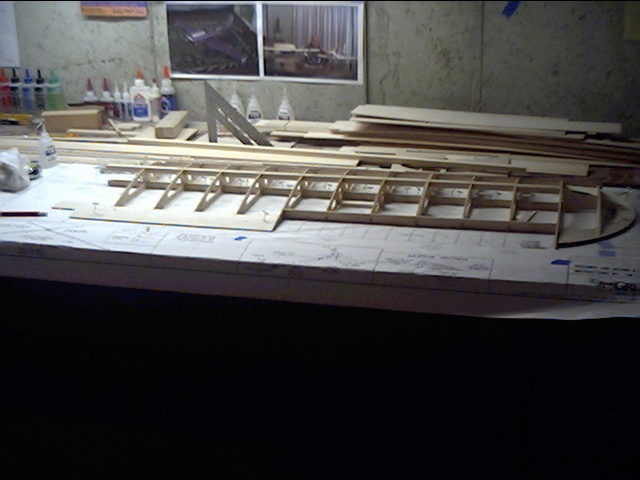

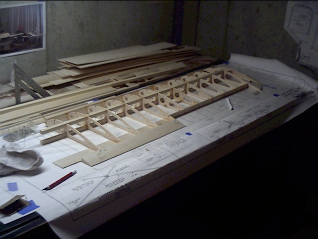

Heres some pic's of my cafateria table for building and covered with the Elmers foam board you get at walmart. Check your local schools and see if they have any they aren't using or will sell cheap.

Elmer Foam Boards are 1/4" thick and are 20"x30" they have foam in the middle and a plastic coating on the outsides. I use three in a row and duck tape them down to the table. This enables me to build a 90" wing in one piece. They are flat and stay flat. They are in the craft dept. at Walmart for under three dollars. I usually get two builds out of each set. Ca glue just wipes off the shiney plastic coating and they hold T-Pins firmly in place. Masking tape holds well for your plans and wax paper, but comes off easy when your done. After you remove them they make a great cutting surface for razor saws and X-acto knifes. Hope you try them. My wife brought them home and said why don't you try these so I did. I wouldn't use anything else now.

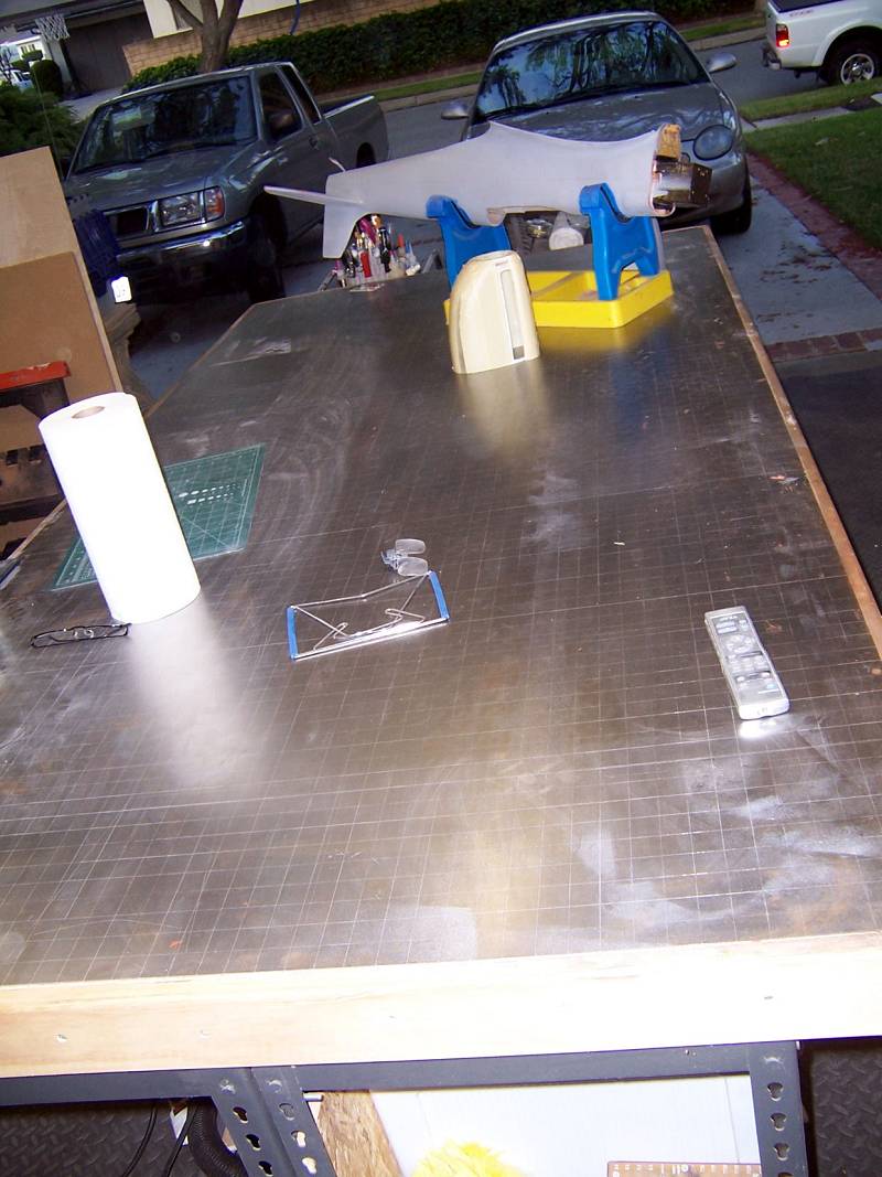

Here's my buildboard. It's a 4' x 8' steel topped island. The top is made of MDF with an internal 2 x 2 frame, banded in 1 x 4 and topped with a sheet of 16 guage cold rolled steel. The base was made with two Gorrilla brand storage shelving units from Costco. I use magnets to build with instead of pins. Check out Paul Johnsons' website for info on using magnets www.airfieldmodels.com

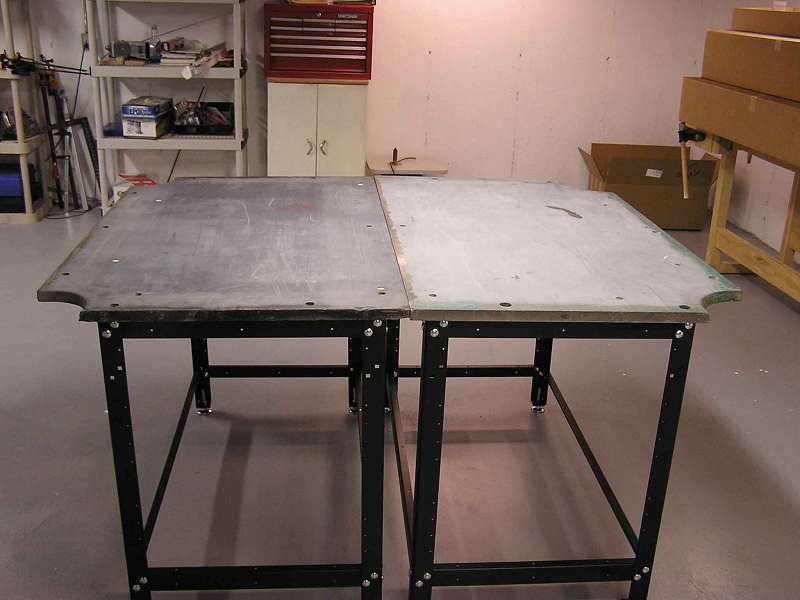

Here's one of my tables - got some leftover slate pool table tops from a local billiard co. for almost nothing (chipped). These are heavy and absolutely flat. Can put tile or whatever over them....
