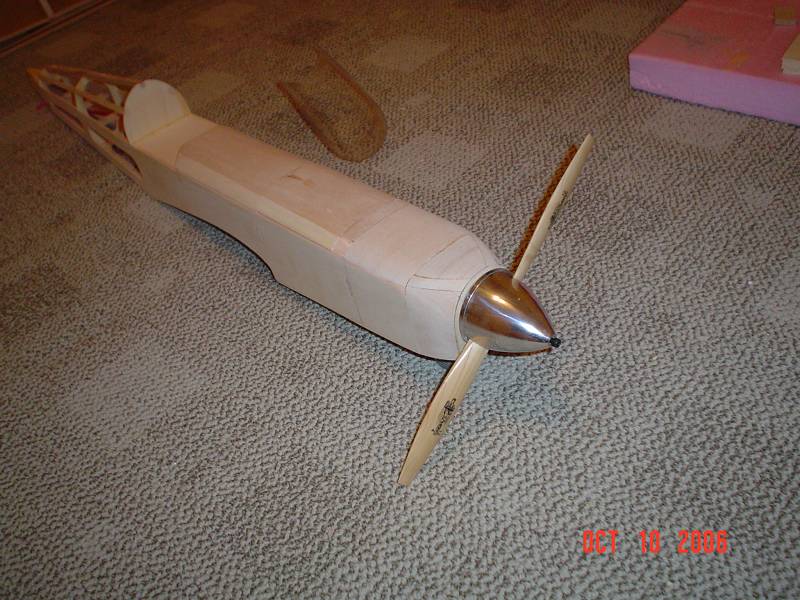

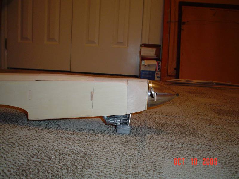

I'm building a Midwest Starduster (almost the same as a Four Star) and I'm installing an ASP .65 four stroke. Anyone inverted their 4 stroke on a Four Star?
Since the thrust line is rather high on the fuse, I though I'd invert the engine and cap off the top of the engine bay to clean it up a little and make it a little different to boot.
If someones done this I'd like to see a picture. Also were you able to get the tank low enough to not use a regulator?

I have a saito 40 inverted on a 4* 40 and am very pleased with the way it runs. I did cut the formers down and put tank at bottom of fus. I am doing a 4* 60 with a saito 100 inverted and plan to make a cowel simmilar to a curtis P40 Warhawk on this one. I do not have a way to send any photos, sorry.

I think I would be concerned with the head being scuffed during a nose over during landing, take off, or ground handling. Other than that go for it. It will look neat and 4 strokes sound so good.

I started with a new Magnum 52 4 stroke on my 4*. Built a custom cowl, but could never get a good idle. It may have been my inability to tune combined with a fresh engine. I sold that and installed a ST51 sideways, ran great. Mounted the ST51 inverted, ran great, idled for minutes with instant transition. Tired of the ST muffler drama and installed an inverted TT46. Couldn't get a reliable idle, mounted it sideways with a pitts muffler. Ran much better untill it ate the carb barrel spring. Tried a fresh Saito 45 inverted, but couldn't get a reliable idle. Mounted the Saito sideways and now have a few hours on it and it is getting real sweet. I may invert it at some time again just to experiment.
I had a Saito 65 inverted on a short lived Venus. It was the only engine I could get to run inverted with the tank mounted up high. Tried a TT46 and Webra61 as well.
I read on here about so many people who never have problems running inverted. I don't seem to have the Midas touch, but I haven't given up yet.
Good luck, MikeB

Well I did it. What do you think?
ID:	538897   Click image for larger version
