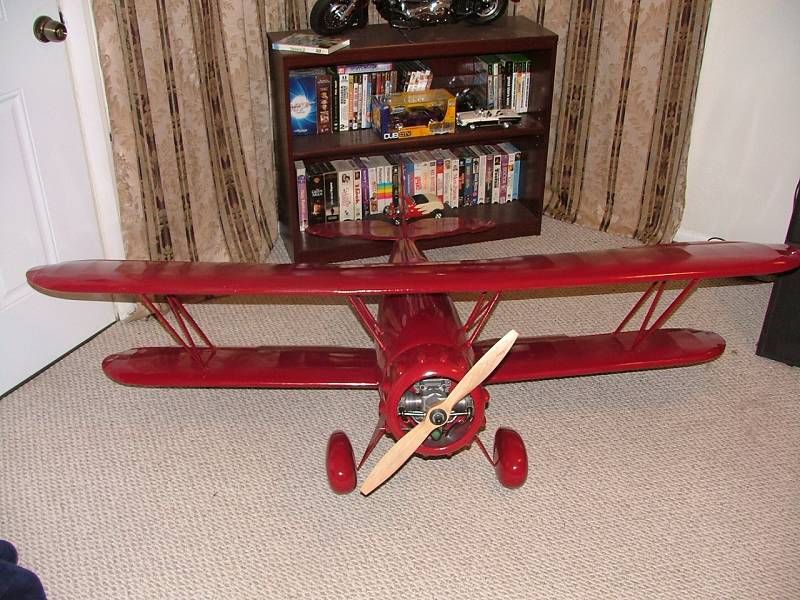

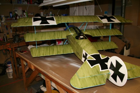

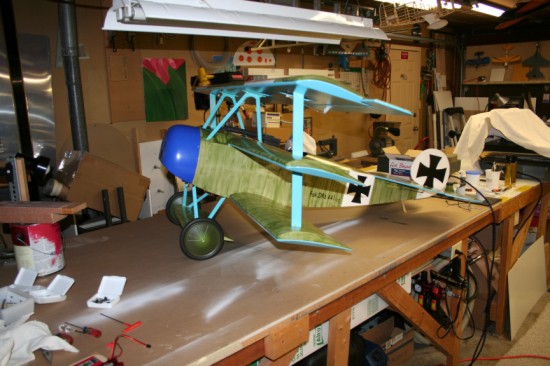

The Solartex is very user friendly. I discovered the tex's long ago using Worldtex purchased from Indy R/C. It is a superior covering material compaired to Monocoat, especialy sing MC seems to have changed. The only issue I have with the Solartex is it will sag some and loosen from sheet surfaces with temperature and humidity changes when coated with latex. This seems to be less of a problem when coated only with clear polyurethane (no latex paint on solartex) to seal the fabric with. I am finishing up a Dr1 Solartex cover, acrylic latex and minwax satin polyurethane. Next time I will use the Koverall and attatch it with Polycrylic, seal with Polycrylic, latex paint and Polycrylic clear coat.

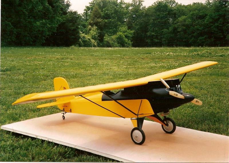

I am a proponent of Koverall, and you have been slightly misled. (probably not on purpose) Koverall is a lightweight (.5 oz/yd2) woven dacron fabric. It is most like ceconite that is used on real airplanes. The guys are correct in that it requires dope to adhere the fabric to the framework. Nitrate dope works best here. They are also correct in that it can fray if not cut correctly. The correct method for cutting is to use pinking shears. Koverall is very easy to apply, and is very forgiving, and you can achieve any type of texture that you require. I will attach 2 different photos of different aircraft that I have done using Koverall. The Corben is finished in Dope, while the WACO is finished in 2 stage automotive paint. The reason for using the automotive paint is that I needed to get a higher level of shine than is possible using dope. Please note that the WACO does not yet have any trim painted. That will be next.
You may have noticed that I do not ever use any iron-on covering. I think that the plastic ones look phony, and I do not like the way that the iron-on fabrics look when completed. This is not to say that they are no good, but just a personal preference.

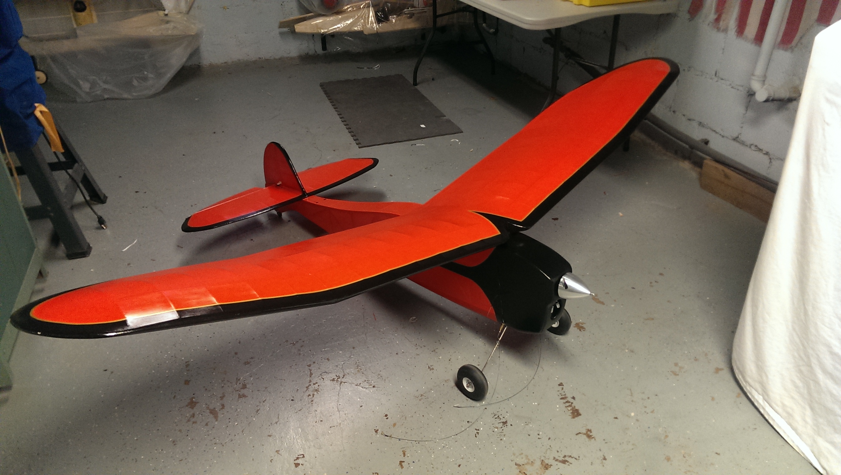

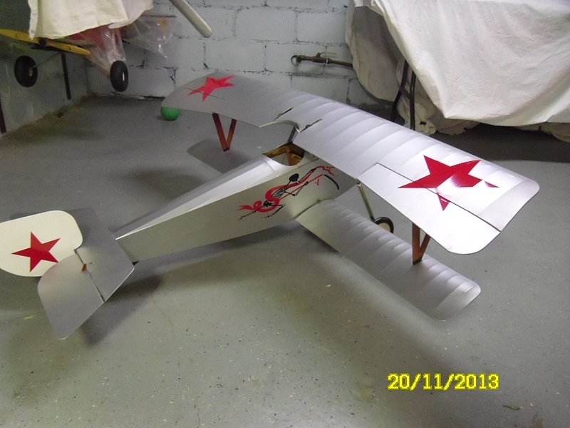

Old 02-11-2018 | 09:39 AM
Joined: Oct 2005
Posts: 99
From: dumont, NJ

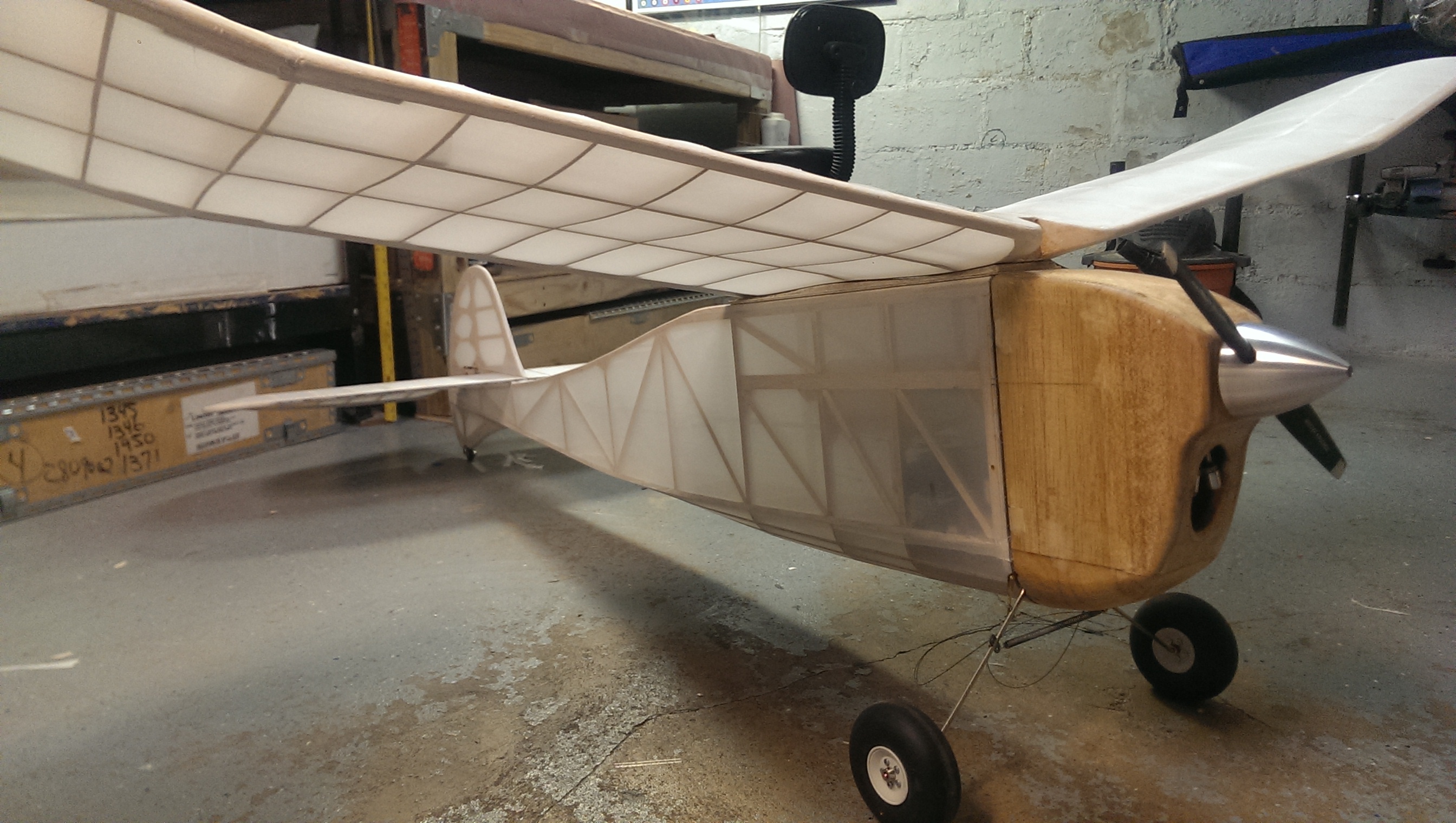

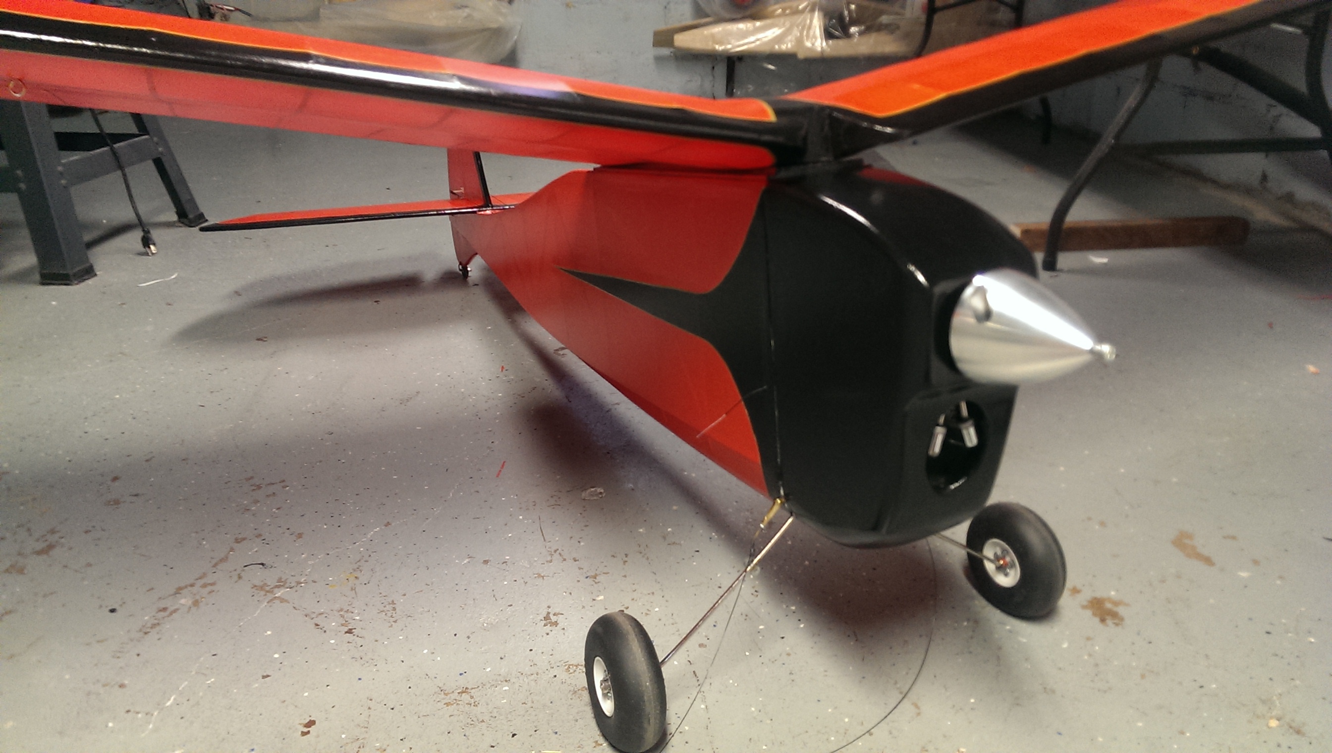

a friend send me the link and I started to read this tread because ,i'm looking at my finishing covering options and fuel proof methods ,I'll explain .. I always used sig koverall well most of the time ,and it's great ,it takes longer to get the job done, due to the fact that you have to 1st applied the glue to the surface/frame ,(sig sells stick it but stinks and it's messy to clean up ,but there's a solution to that u have to use deluxe cover grip, it's like white glue and it's heat activated once you paint the frame with it you place the fabric on top and iron it and done ,then after all that is done u have to seal the wave of the fabric using burathane dope ,,(3 coats I usually use )sanding in between ..and then after all that is done you have to paint the plane and fuel proof it now here's the problem ,I used to use nelson hobby paints ( you applied it with a foam brush),most important THEY WERE FUEL PROOF when u add crosslinker drops (cross linker is a fluid u add to the paint and nelson paints sell it with the paints )but the guy is out of business ,so now because I don't won't to try smelly paints or poison paints and spray guns etc, I'll maybe try latex and fuel proof it with varathane clear finish (never tried this approach ) ..again it's a longer process using sig fabric ,but at the end it's way cheaper than solartex,(in my personal case that I have the dope ,the thinner, fabric ,and glue ).So you have to valance that if u choose to use sig fabric.you will need burathane dope ,burathane thinner,the glue I mention and the fabric ..
Now I did try solartex and it's great!! you applied it like monokotte it's thin enough that takes the curves perfect and comes in colors ,and looks like fabric ,I never try painting it so I can't give u advice on that ,only problems 1) to expensive for a 2 m roll , 2) it's not longer goin to be made and when it's gone is gone ...
about being heavier or not well I'll put it this way the engines on those planes picture right here will lift a plane twice that side ,so for me the weight is not a concern I'm not building gliders .
I posted some pics the n11 is all solartex ,the old timer it's all sig fabric and nelson paints ..
My personal recommendation to you is that u go with solartex ,will be easier in a way to applied , will look nice ,and in a way compare to sig fabric if you don't have all the stuff u need will be cheaper ,even if its $20 a 2M roll ..
I hope my experience with these products help ..
