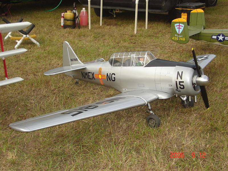

I just purchased a Midwest AT-6 Texan with a Saito 1.20 and Robart retract system. The plane has never flew and the engine never fueled. I consider this a lucky find since it's very detailed with full scale features. My question(s): What is the balance point for this aircraft and where do I measure from....Front of wing leading edge or front of wheel well? The gentleman I bought this from loaded the nose with lead apparently to make it balance but I must be sure he was acurate. Also, what weight should this plane be at for normal scale flight? And finally....how many pounds of air should I pump int the two cans in the retract system? I tried at 80 lbs. and the system worked fine..but for how long? Should I pump more?
For those of you who have this plane and care to help me out....many, many thanks.

Mine weighs about 14lbs with an A&M 2.0 gasser. I think the 1.20 will be borderline power, unless you are really light. Mine needed 1lb of weight on the firewall, and balances 6 1/4" back from the front of the wheel well. The plans show the balance point at the point where the wheel well cover meets the sheeting, (6 1/4"). I don't have flaps and the landings are hot to say the least, but the model is very good flyer. I usually use about 100-110# of air.

At 19lbs, I would consider a G-38, or similar. The one I have was originally flown, by the previous owner, with a G-38, and it balanced perfectly without any ballast.

I checked the plans tonight, the C.G. location is between 3-7/8 & 4-7/8 from the LEADING EDGE of the wing, not the wheel wells.
