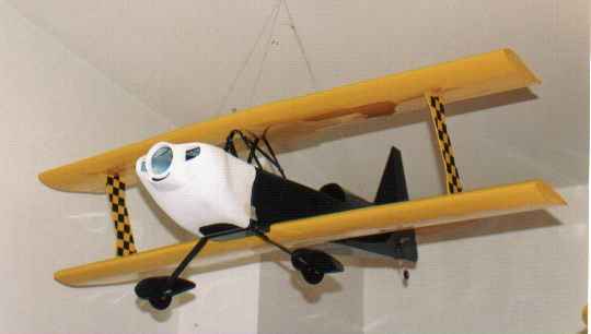

Check it out

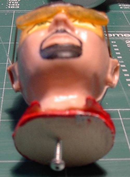

Using a Zona saw, cut off the bottom of the pilot figure to establish the correct width and height. Using a sanding block, sand the cut until even. Place the pilot figure on a piece of lite ply and trace out a pattern. Cut out the pattern and sand to fit the bottom of the pilot figure. Epoxy in place and drill for a screw.
It sounds complicated, but is in fact quite easy and doesn't take long at all.
Regards to all.
(Please excuse the blurred photo, I'm still trying to figure out the new digital camera)
