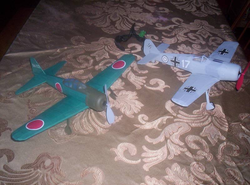

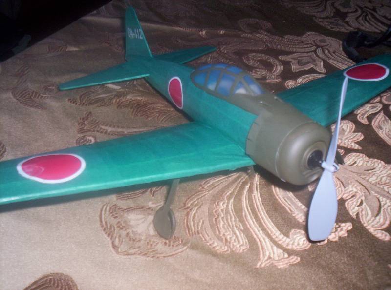

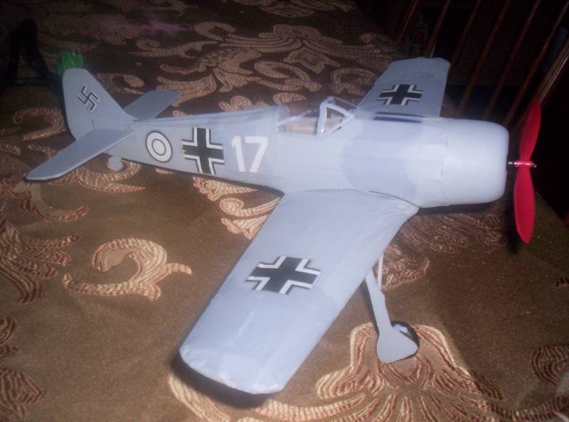

I just placed an order for my first RC kit, a Sig Four Star 40. To warm up for it, I too just built a couple of stick and tissue models. I first did a Guillow's die-cut FW-190 and covered it using thinned Elmer's glue instead of dope. It came out OK, and I had fun building it. Next, I built a Dumas models Zero, which was laser cut, and the quality was much better (also was 3x the price). I used dope for that one, and the covering came out a lot better.
The thing that I can't get over, particularly with the Guillow's models, is that the instructions show them being built by ten year olds. I realize that this is probably who used to build these kits 40-50 years ago, but I cannot imagine my 11 year old son being able to build one of these by himself. This is a little depressing, actually. I am just pushing 40, and even when I was 10 I had already fallen prey to TV and video games.
Anyway, from what I have read about the Sig Four Star kits, I feel I am pretty well prepared to tackle it now.

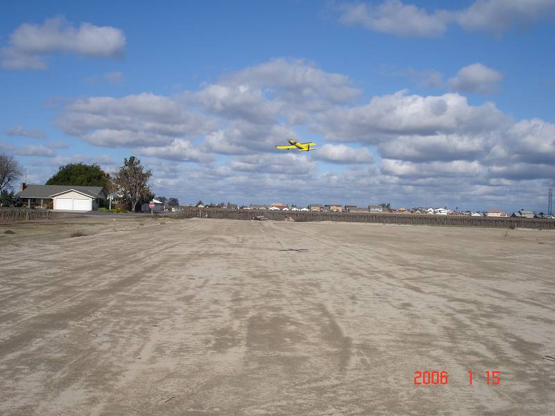

Nice builds, mclina, thanks for the pics! I actually took my Guillow's to a club meeting for "Show and Tell" and was heartily congratulated for completing it by some of the older, veteren model builders.
We met in the local community center where we fly small electrics in the gym after the club meeting. I decided it would be fun to launch my Lancer and see if it flew. The first flight demonstrated that I needed to add some nose weight. On the second flight, after I taped a penny to the nose former, the plane flew almost perfectly down the entire length of the gym and landed perfectly on its gear a few feet from the far wall. I got an ovation from everyone who watched the flight.
Watching something you built from sticks fly well is gratifying indeed!

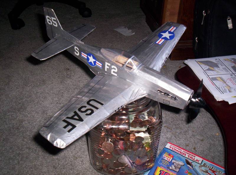

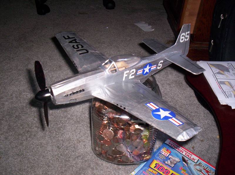

After completing a Sig 4 Star, and another Guillow's kit, I think I agree with those who say that while the Guillow's kits are fun, they probably do not help much in preparing you to build larger planes. This P-51 I just finished had the worst wood and the worst die-cutting I ever saw, and I nearly chucked it in the trash after a few hours of trying to punch out some very questionable parts.
I pressed on though, and this is the finished product. It is pretty rough compared to the Dumas Zero I built. Comparing the actual build of this plane to my 4 Star, excluding radio gear, I bet I spent twice as long on this model as I did on the 4 Star.
I would almost go so far as to say that you should build a larger kit to prepare yourself for one of these little tissue monsters, especially if you go with $8.95 kits like I have. They are definitely a challenge.
