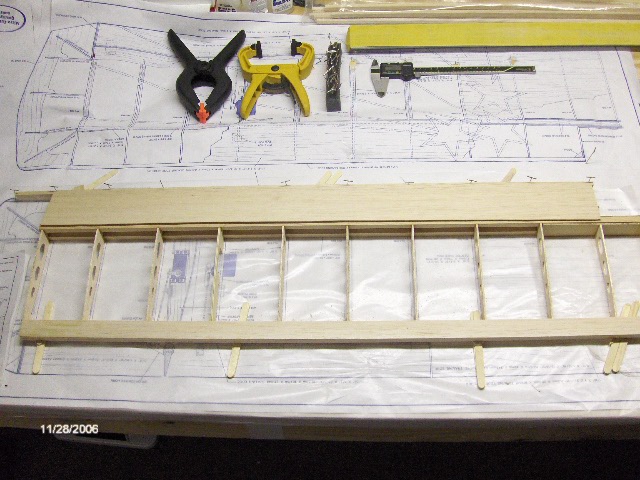

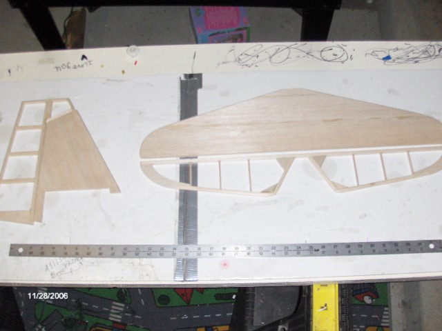

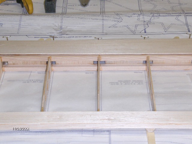

i am starting a build thread of a midwest citabria 1/5 scale. this is my first kit build. its going pretty good so far! I have
completed horizontal and vertical stabs. Rudder and elevator. I am about 2/3 way on wing. I am learning a lot and have
help from building friend NCIS. I would appriciate any tips hints from other builders of this kit. I will power it with os 91 surpass.
iI have attached photos of progress thus far. will try to add mopre as build goes along. thanks in advance for any tips,suggestion
ect. andrew wisc.

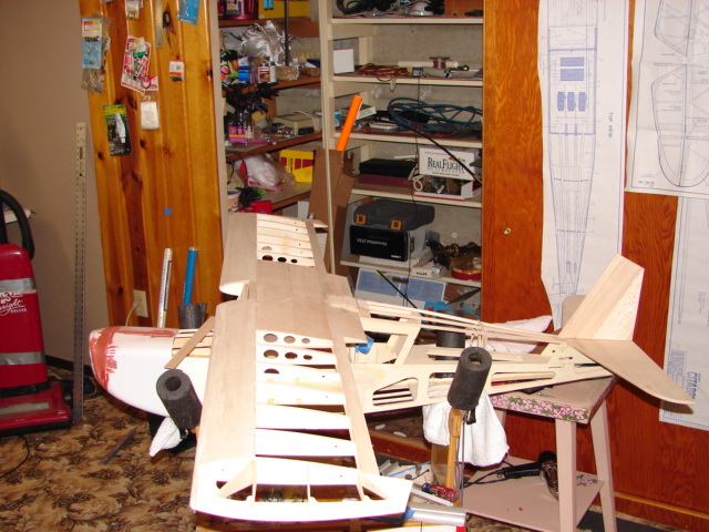

I built my wing flat with 3/8 washout in it also clipped it by one wing rib. The sevos I used 3.8 spruce between the ribs and mounted them so they were horizontal. Makes it easeier to install then just used scrap balsa and reinforsed the other rib around where I had to cut the rib to except the spruce square stick, then sheeted it around the outside so I had a place to attach the covering, the clipped wing is about 72" and has a OS 91 surpass on it. Plenty of power and flies super. Kind of plane a guy needs a chair so you can just sit down and relax. here is a few pictures, the wing stuts are not in the picture but I would suggest that you make them. The pictues are from maiden flight I then installed them afterwards GOOD LUCK YO WILL LOVE THIS PLANE!!!!

looks sweet onewingglow. hope mine turns out this good. i will definetly go with your wing servo mounting plan. much easier than
trying to utilize factory mount. im planning on using os 91 four stroke w/ 14 x6 prop. did you use factory tail wheel set up?
if you did how did it work. i will be flying from somewhat rough grass field. also did you go with std wood pushrods or other.
i havent gotten much time to work on lately with holidays . am married w/ 2 daughters 10 and 6 . the 6 year old is full of spirit
a good quality but not condusive to model building.happy holidays! thanks for comments. hope to be posting more pics soon.

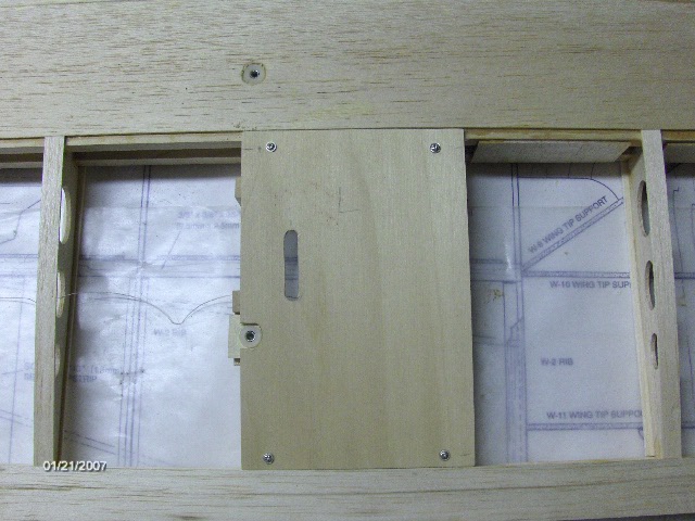

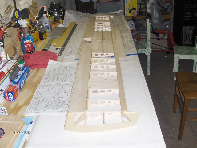

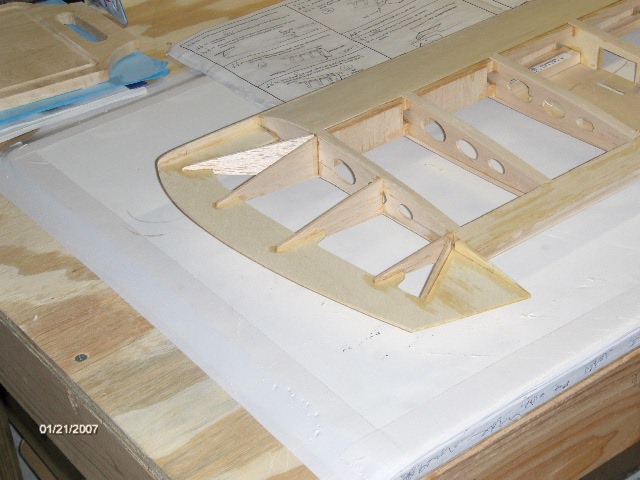

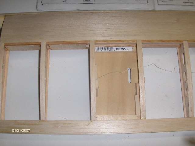

hello everyone .

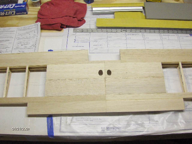

well the wing is finally done ! here are some pics.

Looking VERY good. One thing that I see is the plywood hatches for the ailerons. How are you going to get the covering flush but still allow the hatch to be removed? Usually there is a bit of sheeting on either side that remains attached and allows you to attach the covering over the rib. Your plywood looks flush in the image.
Old 01-22-2007 | 06:04 PM
Joined: Mar 2005
Posts: 203
From: milton, WI
Default RE: midwest citabria build thread
hello charliep.
you are right . i have the single piece mounted over ribs. i have yet to mark from other side where hatch outline will be.
this will be cut out thus leaving plywood frame for covering to attach. additional blocks will be added to sink hatch down slightly to
make flush. i went with factoryu servo monting in the rib . this hatch is for acsess to servo screws and servo is not attached to
hatch. this is my first kit build and learning a lot. this is what i came up with and i think it will work. what do ya think.? thanks
for comments greatly appriciated. have you built the midwest citabria any hints tips more than welcome. thanks andrew wisc.
