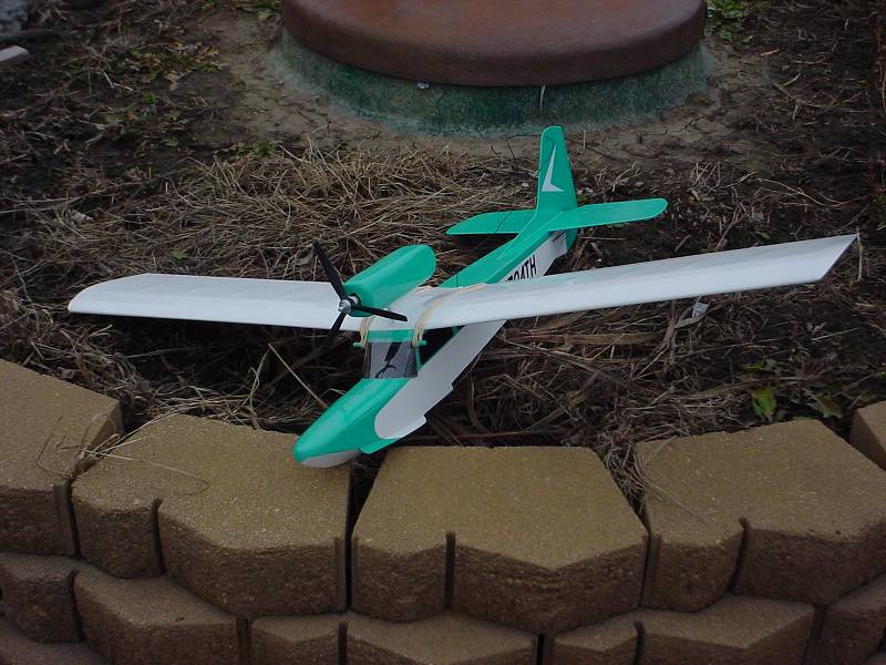

I just built one with a Grayson Hobby Dynam A22-15M Brushless motor, http://www.graysonhobby.com/catalog/...products_id=56 and a Dynam 25 amp controller. I use a 3 bladed Master-airscrew 6x4 prop and 1650 11.1v 8C lipo pack from Common Sense RC. It has plenty of power to row. Be sure to add the recommended chine rails.

One thing I forgot to mention is to be sure to remove the factory built in downthrust. If you search many of the Aquastar build threads here on RCU, you'll learn that getting the plane to ROW is next to impossible with any downthrust. I built mine with zero degrees thrust. Thought of this while flying mine today. It was fairly cold but hardly any wind. Oh and if you use the motor, esc and battery combo I did, you'll see average flight times around 15 minutes without the motor cutoff kicking in.

Removing the downthrust and converting to electric power were the only deviations I made from the stock kit. I used the recommended control throws as well. My all up weight is 628 grams or about 22.15 ounces with tip floats. Yours will likely be lighter with the .061.

My Aquastar flies great. I try to fly only in less than 5 mph winds but have had it out in 10 mph winds before. She gets to be a bit harder to handle in the stronger winds.
Be sure also to seal the wing saddle and windshield. I used silicon chaulk and waxpaper to form a watertight seal on the saddle. It was flown off water before I did this and I wound up with a bit a water in it. Dried it out and sealed it and haven't had any problems since.
