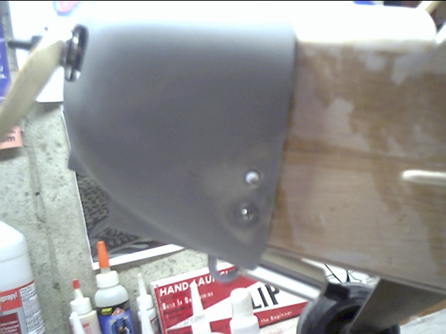

I have a 90" wingspan Great Planes Cub that I converted to a super Cub with a Fiberglass Specialties cowling. My Magnum .91 4-stroke engine is inverted and doesn't even exit the cowling. I am almost finished building mine. All thats left is filling, sanding. and covering. It will be covered in fabric and then painted. I do still have to build the floats for when I want to fly off water.

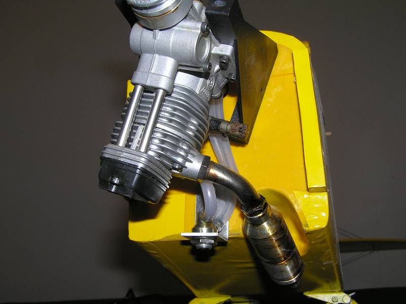

It's probably flown more than any L-4 did in WWII, but hasn't been shot at as much. I'm not really sure just how many flights it does have, but it's flown at least one flight every month since I built it, and some days gets as many as four tanks of fuel through it. My .65 is starting to sound as though I might be losing a bearing; there's no resistance, tightness or play in the crank, doesn't knock, and it pulls as well as ever. I have another one new in the box, but hope it will go on another plane.
ddrake, here's my inverted installation, note the muffler type I was talking about. I had to heat and bend the elbow a bit to get the exhaust to exit the bottom of the cowl, this was before that "button" style elbow was available (special order). The brass tube that runs down the left side of the firewall is for the crankcase breather The engine mount is a DuBro antivibe mount.

It looks like the firewall was cut away and recessed is this due to the engine or the mount?

You may want to lower the tank a bit. The Sig Cub has a "tank floor" that is notch located behind the firewall. It's no big deal to lower it; mine is still high enough that I can slide my Rx battery pack under it. You want your tank centerline even with to about a 1/4 inch below the height of the carb spraybar. I have a 12 oz tank in mine. My Cub was my first inverted installation, and I put an on-board glow on it to forestall any problems, but once I got the carb adjusted , it's run fine without using the on-board system. I still use it for starting; you'll have to put some kind of remote plug anyway if you go inverted, the glow plug just isn't accessible. I set my system up as a manual, and can turn it on and off whenever I want from a Tx switch (mine is the MPI SuperGlo).
