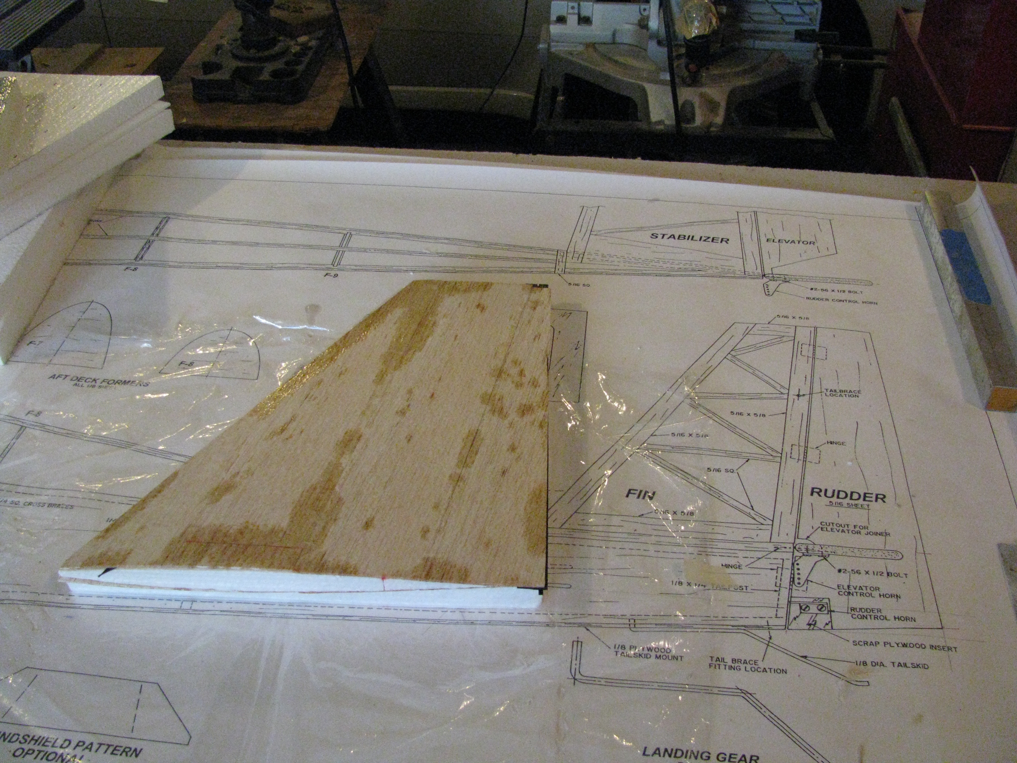

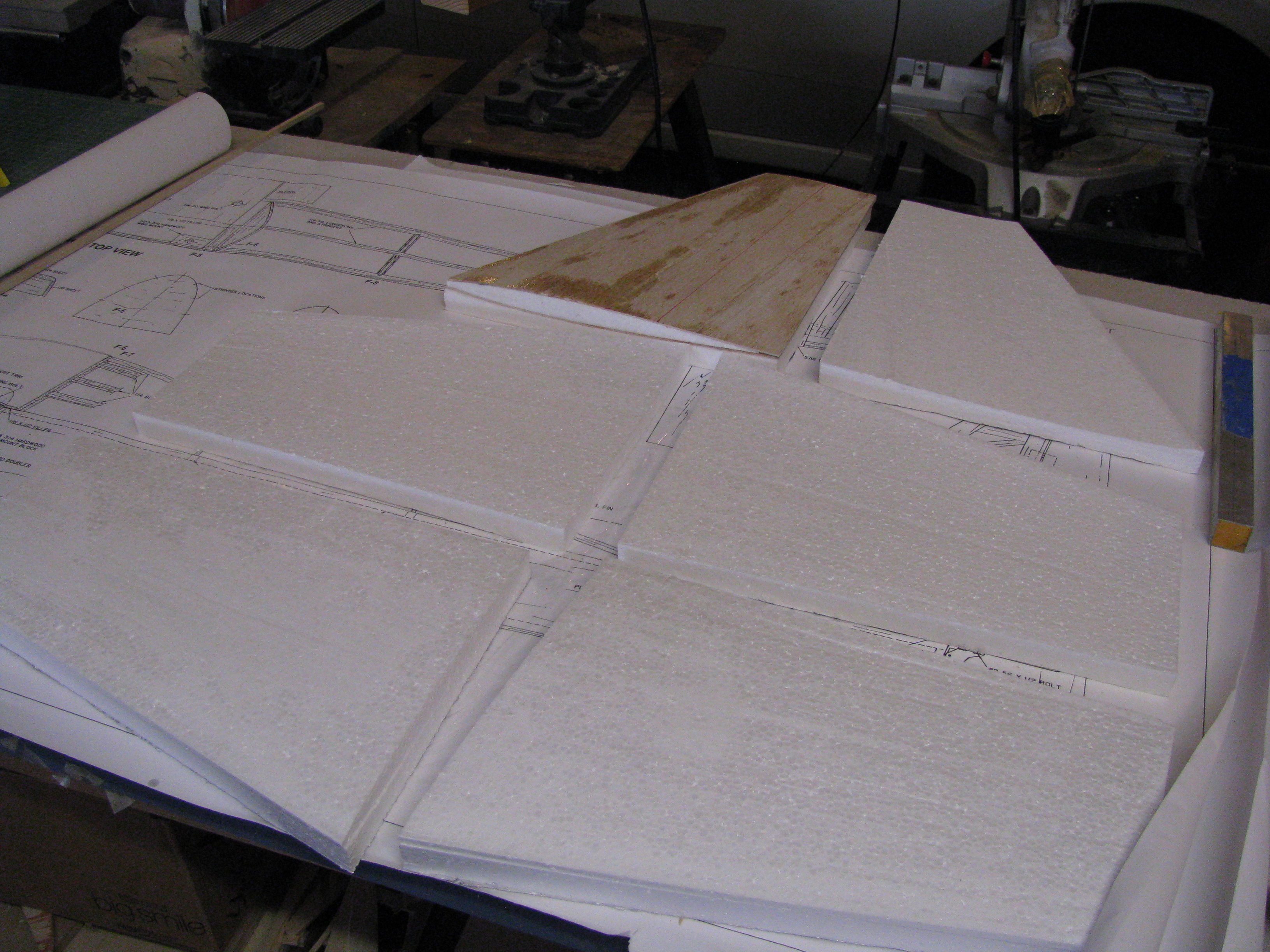

Tail feathers ala NACA 64006a
My version of tail feathers for a Stingray 120 converted to low wing. I cut cores from white foam and sheeted them with 1/16" balsa.
This was an old Stingray 120 kit that I never got around to building.
vertical stab, before cutting out rudder.

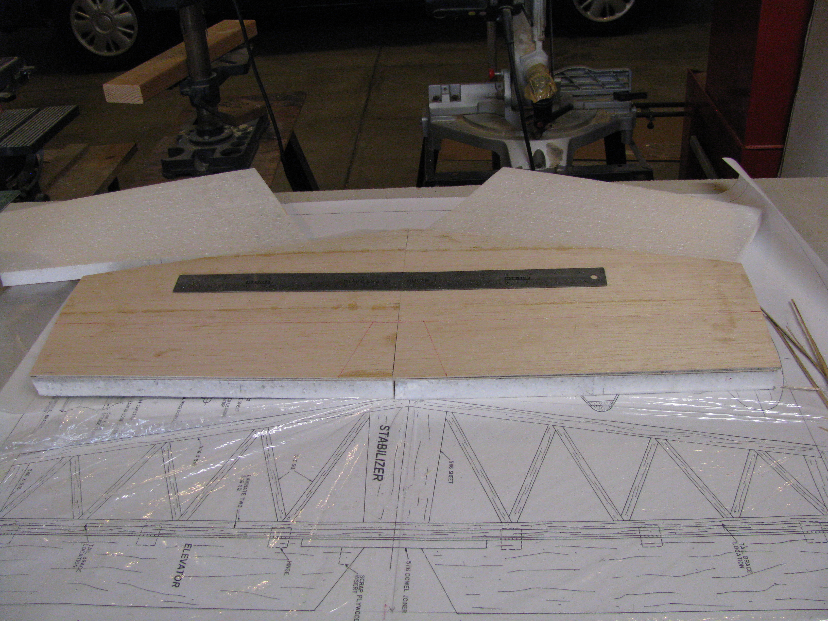

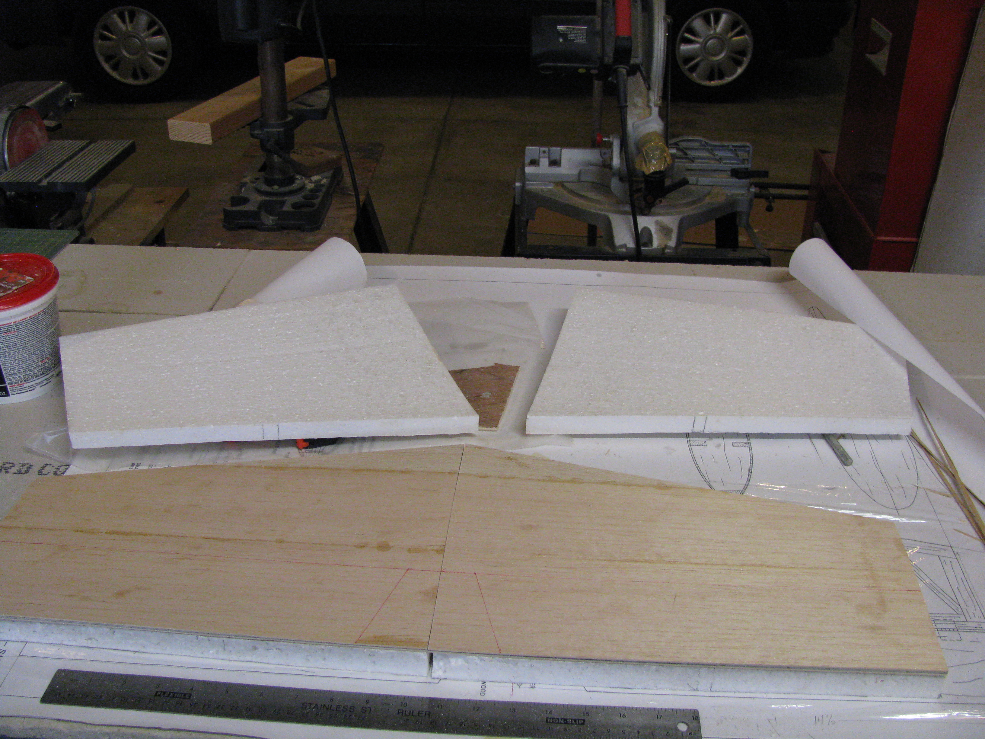

Horizontal stab cores.

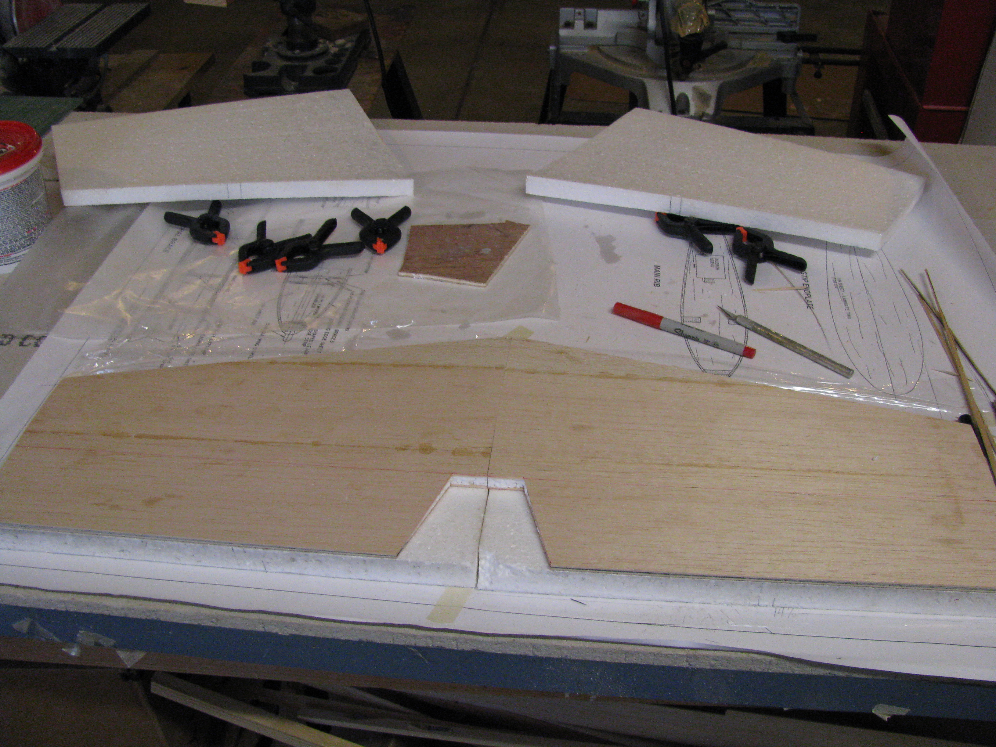

After sheeting
contrasted to the plans.
Elevators

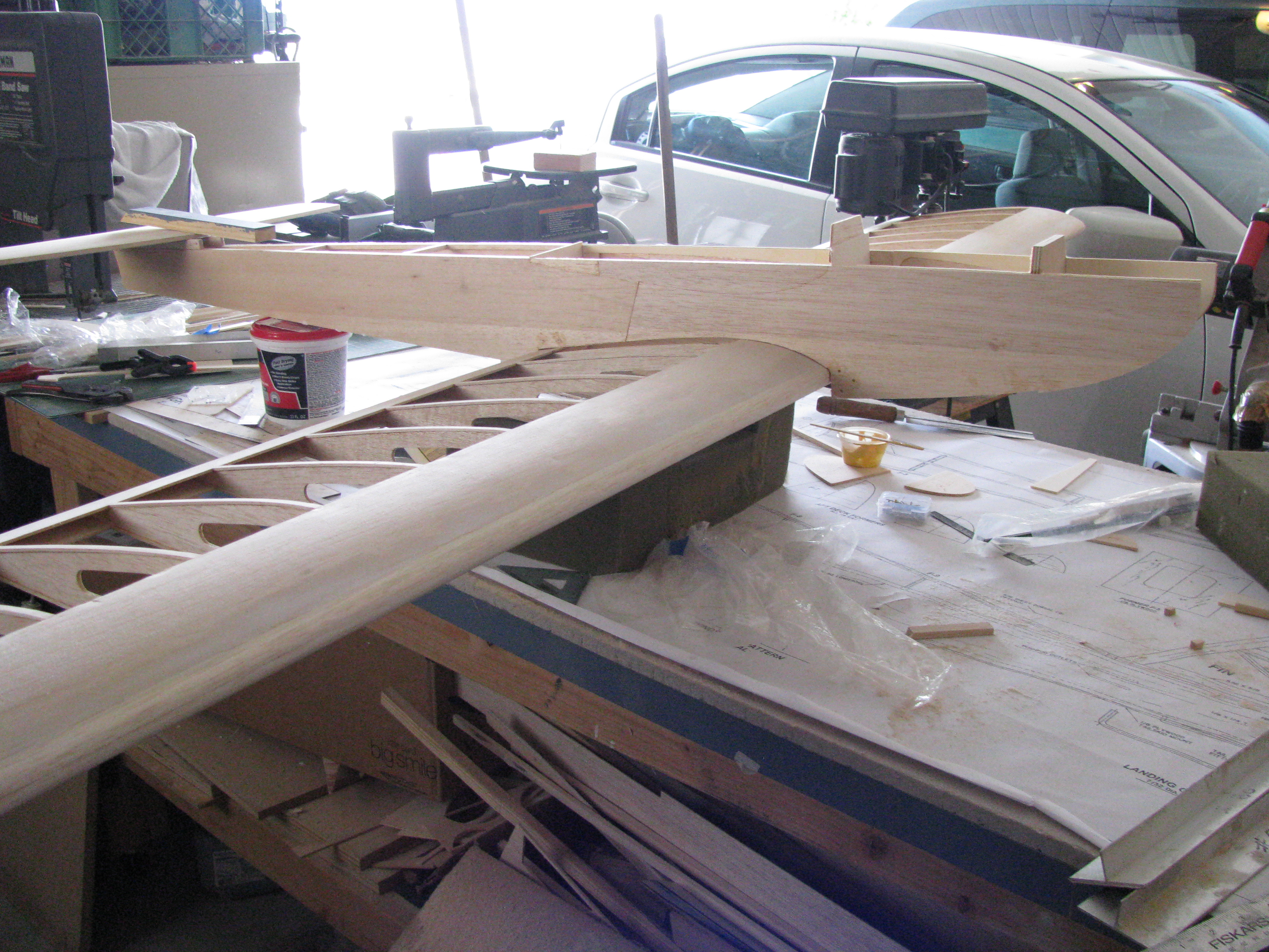

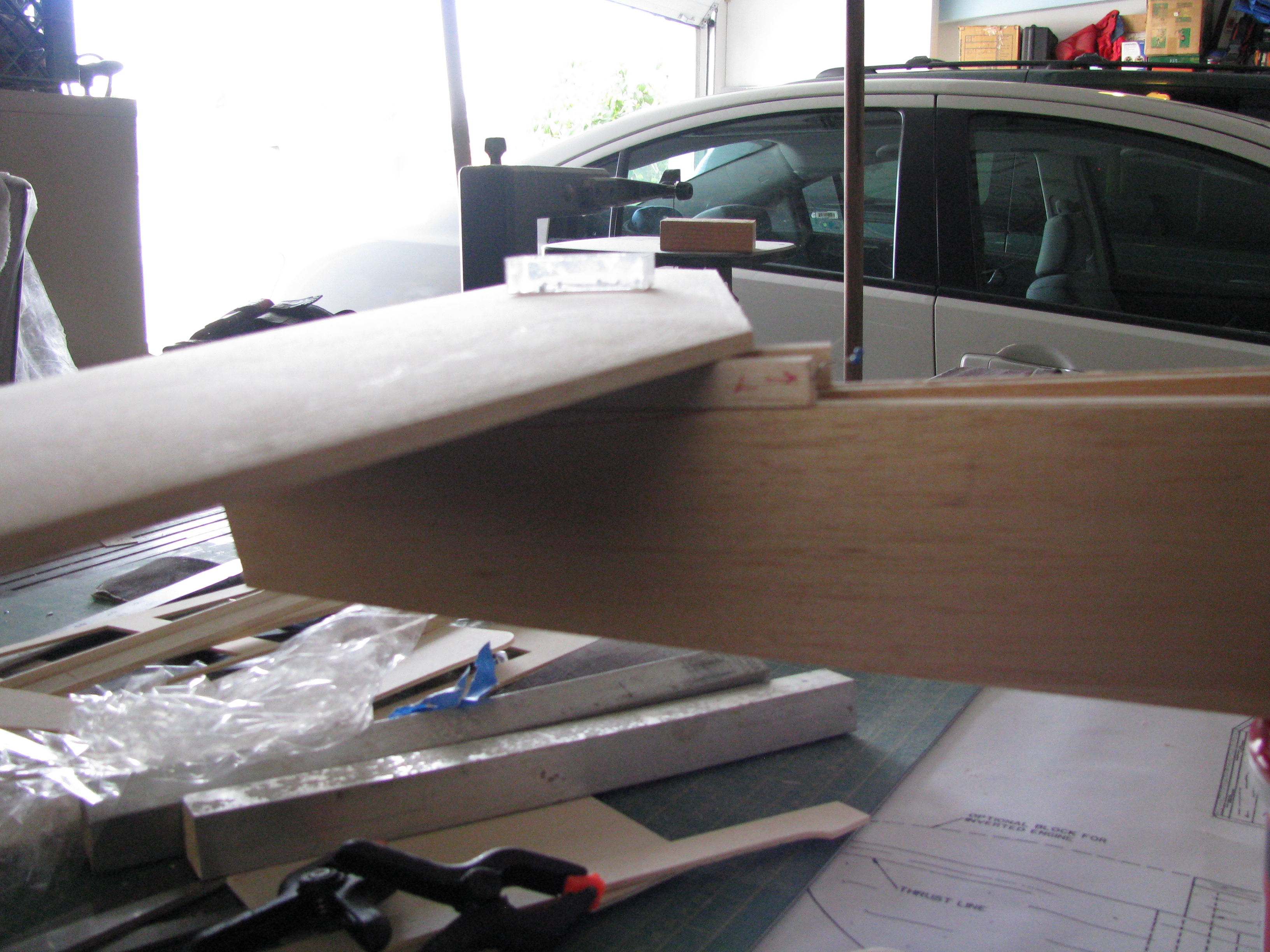

Since the tail is now a flying airfoil instead of a plank,
a saddle is required to fit the horizontal stab.
