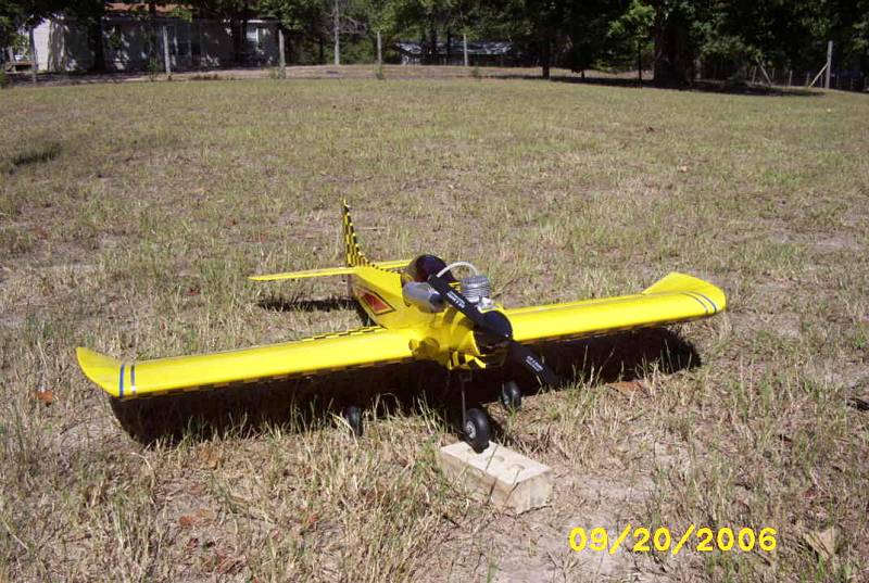

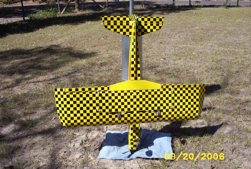

Finished mine in Sept. 06. Flies great. It had the upswept option. I installed the flaps, widened the ailerons, straightened out the rudder, made the cowling so that I can pull the engine (OS .61FX) out the front and the air scoop is functional and can be removed, exposing the bottom of the engine.
This plane really files great. Definately, point and shoot. Very fast, but very stable. Lands very slowly with flaps and lands somewhat like my trainer without flaps. No tip stall tendencies.

Thanks for the pics. I've actually built that same plane you have, and yes--it does fly great. I now have in my possesion one of the original kits (not the gold edition) that has an upswept wing option rather than just an upswept wing TIP. I was wondering how it flies before I build it with that kind of wing. I really like the looks of it on the box.
