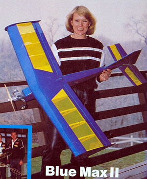

Hello Everyone,
I am taking on a new building adventure with a set of Blue Max II (1985) plans that I recently acquired. For this build I will need cut all wing and fuselage parts and wanted to ask the great minds of this forum for some help. I have built several kit planes now and all have turned out relatively good and proved to be fun planes to fly. These kits have all had laser cut parts and made the build easy however. Will you please take some time to offer any advice you may have on how to cut the required wing and fuselage parts, and any helpful tools you may recommend to make the job easier?
Thank you in advance for your assistance!
