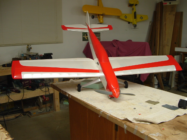

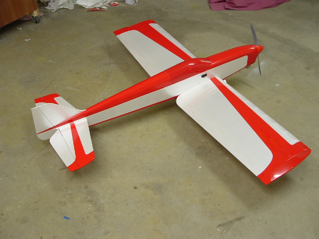

This one Features a built up cowl with inverted Saito, wing is shorter by one bay each side, 2 inches added to the fuse between stab and main wing and canopy moved forward 2 inches for a longer appearance. Fly's great, much like the original Venture but with faster roll rate, it still floats on approach just not as much as a stock one.

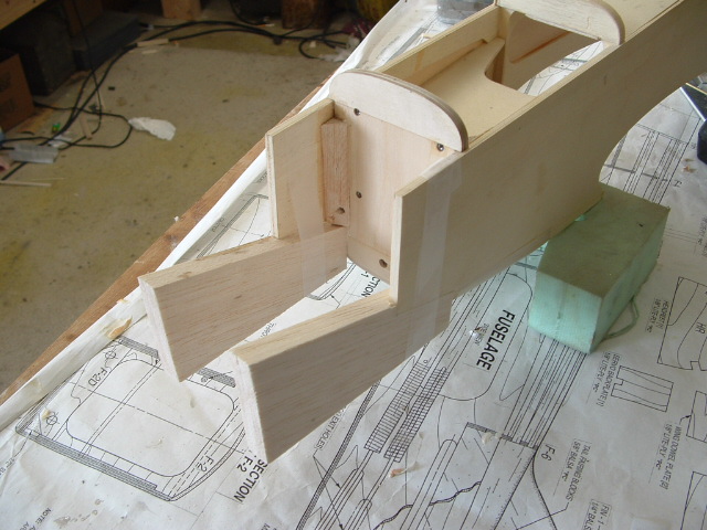

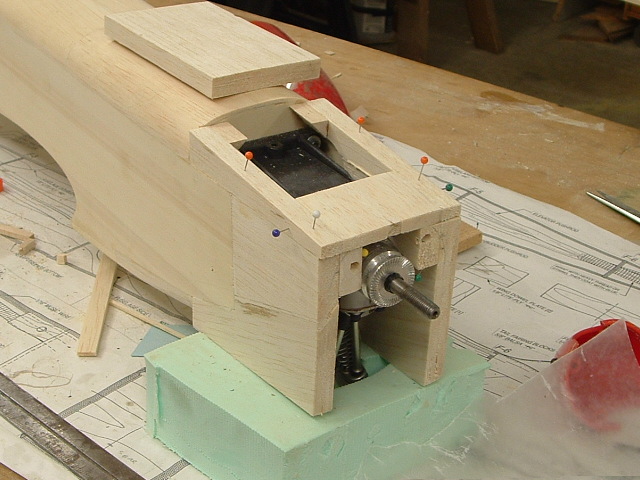

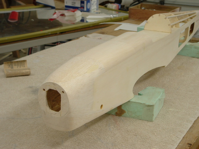

Extending the fuse is more than meets the eye and was mainly done as a cosmetic preference. other than cutting and adding wood to the fuse sides and backing it up with lite ply, the tops of the second and third formers from the headrest had to be relocated and the bottom of the fuse angle was changed a little. Hope these pictures will help you. Its not nessesary to make the rabbit joint on the edges but use elmers glue, its easier to sand later.
