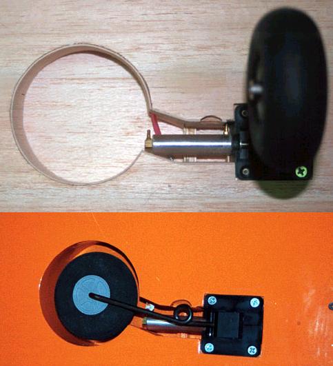

I've done two airplanes with retracts and wheel wells and I used 1/32 balsa to line the wheel wells. The 1/32 balsa bends easily to the diameter of the wheel well without soaking to make it pliable. Attached is a picture of one of them.

Thanks for the great suggestions! I've already got some 1/8" balsa drying around a couple of bottles of a suitable diameter. Katmandew, thanks for the pics, they really help clarify your tip; is that iron-on covering or paint inside the wheel wells? It looks as though getting them to look good with covering would be a major PITA!

That's iron on covering with paint inside the wheel well. I just covered over the wheel well and then cut a small ciccle in the covering and then cut many radial slits and wrapped the strips of covering down into the wheel well using the rounded tip on a trim iron. Then I painted the entire inside of the wheel well, wrapped covering strips and all. You have to get real close and get just the right light to be able to see the wrapped covering strips.
