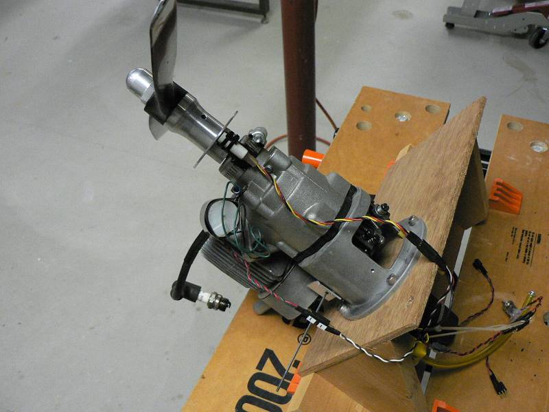

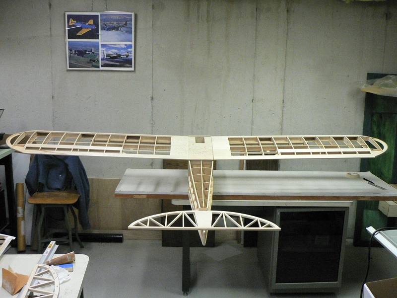

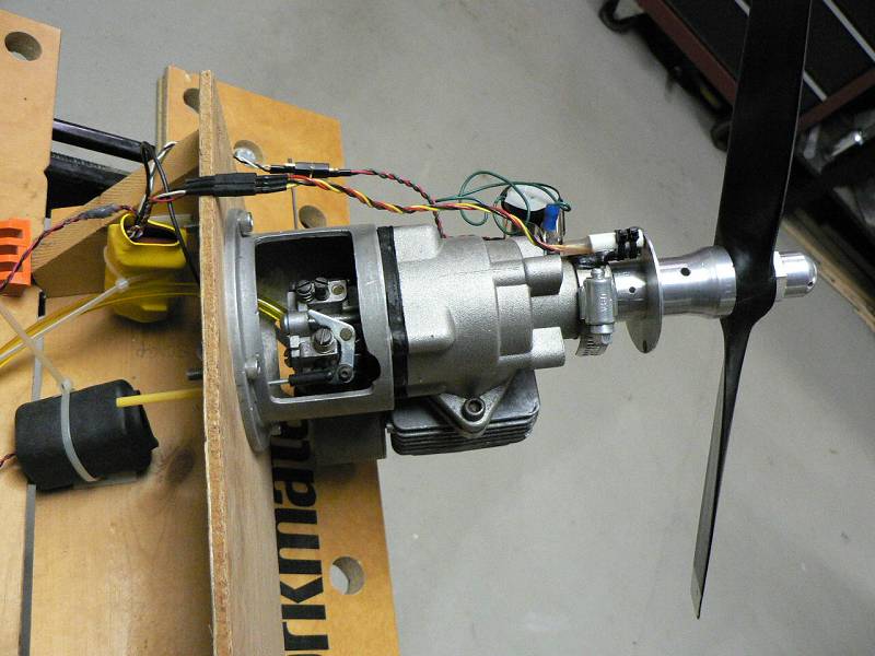

I'm also working on a SIG 1/4 scale CUB with a Ryobi engine. I moved the firewall back a few inches and it looks like a good fit. One thing I'm concerned about is getting air into the carb. Here are some pictures.

SMK... looking very good. Wow, a very neat building area. Will the Ryobi hand crank with the electronic ignition?
Old 02-25-2007 | 11:19 AM
smkrcflyer's Avatar
Joined: Sep 2006
Posts: 1,022
From: Hamburg, PA
Default RE: ryobi powered piper cub
Thanks AA5BY. My work area is very nice it’s about 20ft x 20ft and could be bigger but I don't need the space yet. I have not run the engine yet but I was told its best to use an electric starter. A friend of mine does these conversations. I hope to start doing them myself.
