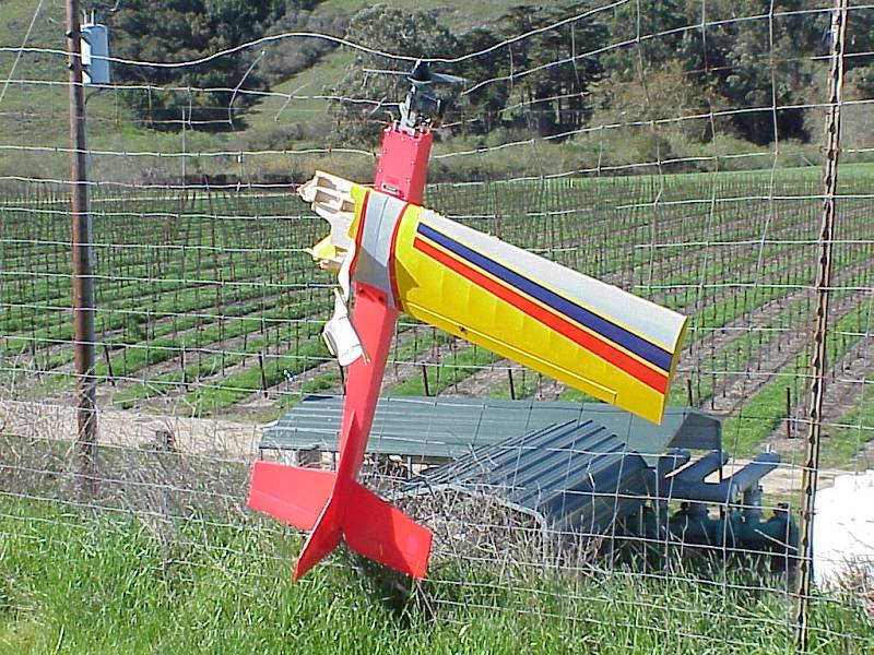

Buzz, I had, with a captial H, a Laniar Explorer 40 trainer. It never flew right. On approach one day a few months back, I got way off line and decided to go right for a go around vs trying to go left which would have brought it over the pits. My instructor thought I was going to hit the power lines, so he grabbed control and tried to go under them. At slow speed, a little down elevator was way to much and he tagged the top 2x6 on a rail fence. Photo below.
The wings and tail were in OK shape, so I built a stick fuselage using the wing and tail. The trainer required a lot of weight under the engine, so I decided to stretch the nose a bit, so I added two inches there. The elevator didn't have any control at landing speed, so I increased the size of the elevators by about 15%. At the suggestion of my instructor, I also added three inches behind the wing. What a difference. I flew it for about a month or so and then lost it in the creek behind the field. I'm not sure just what happened, radio, structural, ???, but it went in like a lawn dart, right into the thickest part of the creek bed, never to be seen again.

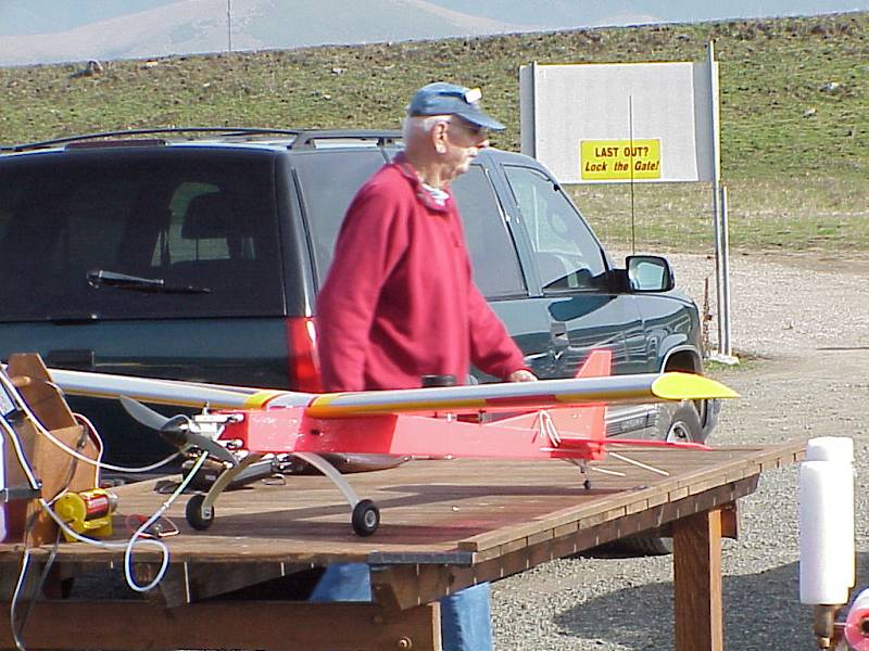

I was out to the field today and, well as they say, a photo is worth a 1000 words. Now, after building two fueslaes to fit wings I had, I need to build a wing to fit this fuselage. I'm thinking that I might go with a Sig four star airfoil and a little less dhideral. I just got my four star finished and flew it on Friday. Looks like it is now my new "main plane"

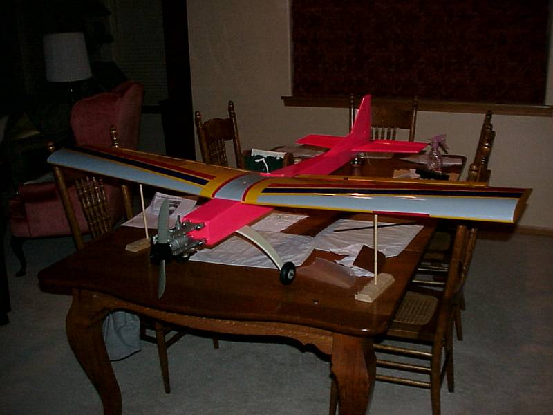

I flew the four star today. It is really responsive, and once I cut the throws back on the aileron and dialed in some more expo on them, it is a realy nice plane. It doesn't handle like the one hanging on the fence though. It has more torque twist on take off, and the tail wants to jump up as soon as you start rolling. I could run the one on the fence up to full speed before rotating and lifting off. The 4* just wants to be in the air. I need a bit more work on take offs before I am as consistant as I was with the fence bird.
The longer fuselage on it made quite a difference. The fuse on the fence bird is the same spinner to aft end of the rudder as the 4*, the wing is 60" vs 72" and the cord is a lot longer on the 4*. To get the same ratio of length to ws on the 4*, I would need to add another 6 to 8 inches to the fuselage. That could be an interesting bird. I'll see what happens, if I have to do a rebuild.
