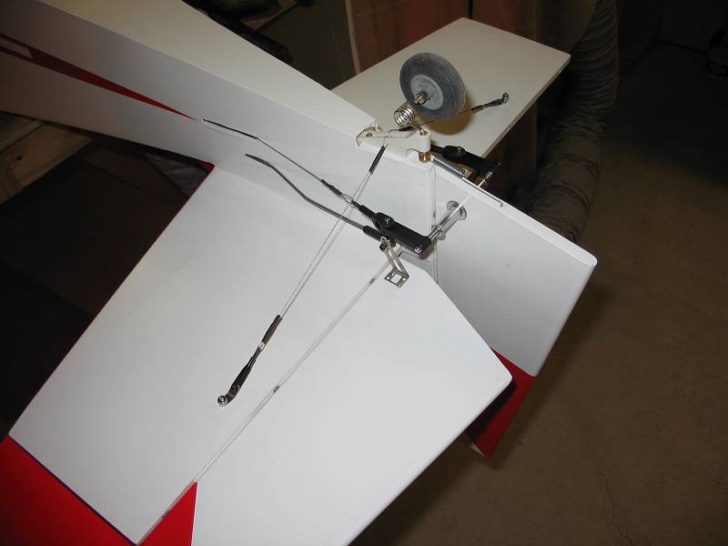

If you want something easier and stronger than the 2/56 rod and ends. Use some of the steel leader wire that is coated. When I did my decathlon I used the 30lb test. The wire and crimp tubes where about 5 bucks, and then use the dubro rigging couplers (dub201) with the dubro quick links (dub109). To fasten to use the Dubro steel straps and bend to suit. (dub 158)

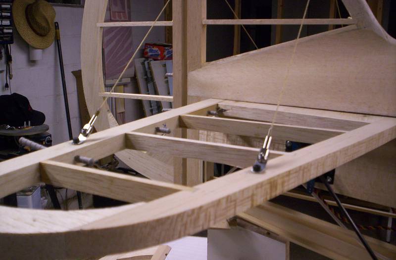

I use a Sullivan 4-40 Brass Solder End, from the solder end, drill into the brass end with a .040" drill about 3/8" deep, cut off the female sleeve and dress the end, solder 1/32" cable into the 4-40 thread piece and use Dubro 4-40 rod ends. I use Sullivan 4-40 nuts for jamming, they are 3/16" hex size.
Here's a photo from my 34% Chisten Eagle.
