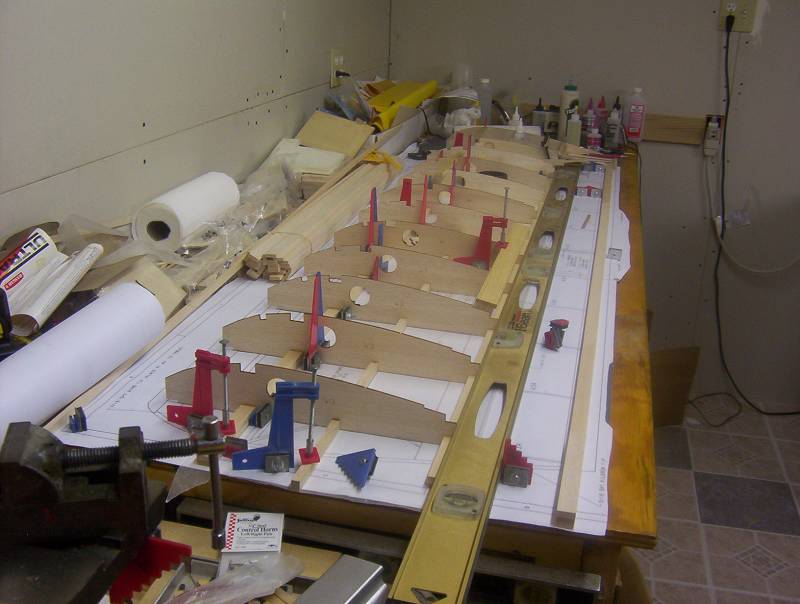

All you have to do is take a razor plane to the LE and rough shape it. Takes about 3 minutes.
I made a sanding block from a piece of 4" wide x 12" long countertop board. It's pressed particle board. It's 3/4" thick. Since it was manufactured in a plant. It's been pressed, glued and cured under heat and pressure--it will never warp. 4x12 is the perfect size to wrap a sheet of sand paper around it. 3/4" won't flex--no matter how hard you push. Long sanding blocks don't cause warps in your LE or sheeting. Short sanding blocks are good for Martha Stewert.
After you shape the LE with the razor plane, all thats left to do is sand it. Start with 80 grit to knock off the majority of it and give it shape. Go to 120 to clean up the groove marks left over from the 80 grit. Finish with 400 grit.
The whole process shouldn't take more than 10 or 15 minutes per wing.

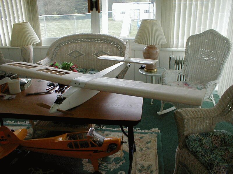

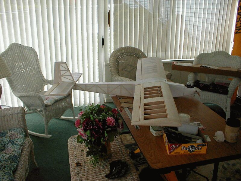

What's fair is fair so I must say that (now that I'm over the shock of the rather crude kit) the plane is going together quite well. While building I keep thinking back to the early 60s which is probably when the kit originated.
I decided to cut the dihedral in half. Hopefully the plane will still be a gentle flyer since I have some young family members that will soon be ready to enter the hobby.
I have a OS 52 four stroke that should be adequate. I guess time will tell on that.
Even though the wing appears to be fairly strong I thought I'd go with bolt on and struts. Anyone else adding struts?

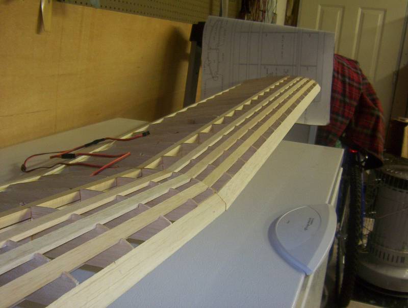

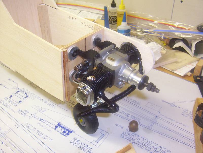

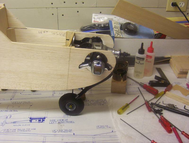

Nice job modding there Bud. I considered sheeting the Tele but opted to stay standard on the wing (other than 1/2 dihedral, no rubber bands and relocating the aileron servos). Instead of flaps I decided to use flaperons. I have seen some negative comments about them but thought I'd see for myself. Nice thing about non-scale is you can add your personal touches.

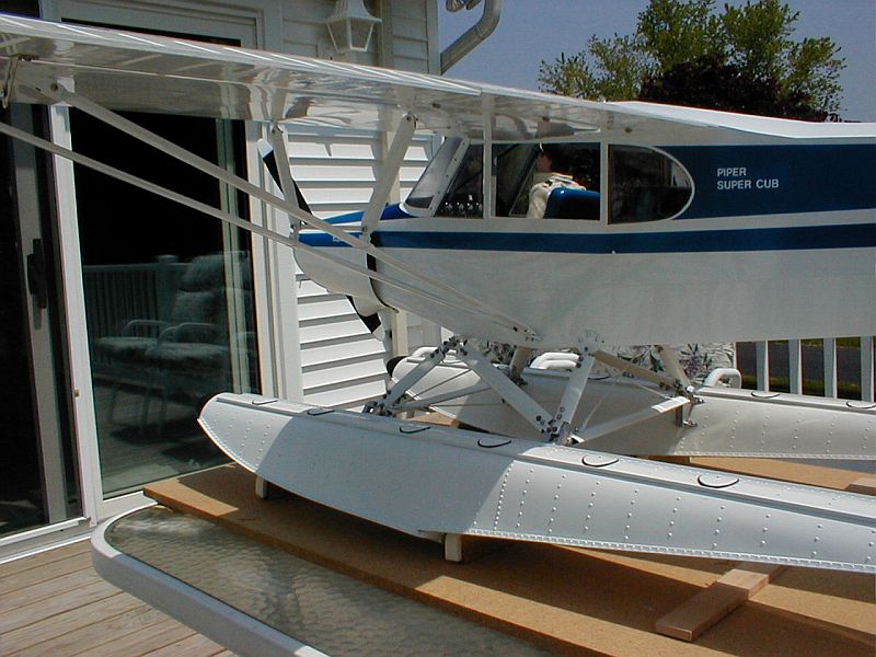

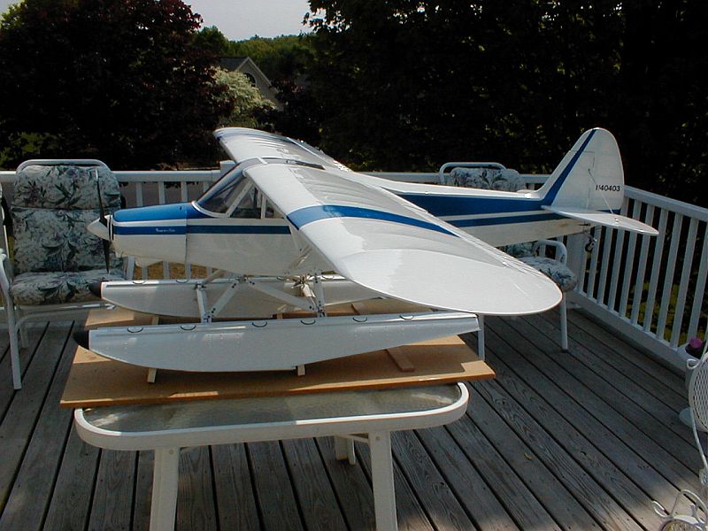

Speaking of scale I see you're a Cub man. Mine (1/5 scale Sig) is not yet finished ,,, it took a back seat to the Telemaster kit.

Thanks sacgate, I forgot to mention my tele is the 40 size and I dropped the dihedral 1" I made a tree landing, actually the tree jumped out and grabbed it.
Tried to get it out for hours and gave up. Went back about 6 hours later after a torrential rain and wind storm and it was still there. I was about to threw a rock with heavy string at it when a gust of wind came along and blew it out. No damage until it landed upside down in a bush and did some wing damage so it's been sitting for several years. I was upset with the covering (coverite) because I finished it with water base urethane and the fuel residue made it sticky, I just this week recovered it with solartex and am real pleased with that product after being talked into trying it.
Yes I am a cub man! I have the Dave Patrick super cub with an O.S.160 twin and electrodynamics on board glow. got mine when they first came out and I love it. Thinking about recovering it with solartex and adding some scale detail but will probably wait till flying season is over.
