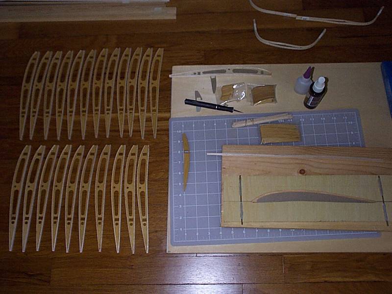

Howdy all, been working on an Antic Bipe project for a little while. I started taking pictures with the intent to post but never got around to it.
I bought the kit off of eBay (I'd been looking for a regular Antic or Bipe, this one came up at the right price). I don't know what changes they've made to the kit, if any - from the dated documentation in the box it looks like the kit was produced in 1975. I'm building it pretty close to the instructions/plans, except for using a hardboard rib jig rather than using pins, the finish on some of the wood, and a few cosmetic details. I'm using "Antique" Solartex fabric on it. This is my first experience with Solartex and the stuff is great!
My build-along gallery is here.

The black "diagonals" are thin/round bamboo. They're made from bamboo skewers I think, but very thin - I haven't been able to find any replacements that were the same size. They're functional though, the fuselage is really flimsy until they get set into position. The "drag wires" in the wings are made from the same bamboo material, they're also functional.

Your rib-jig is the way to go. I originally set out to do a rib jig like yours, but settled on just pinning each half down. Either way it's far better than trying to use the multiple-pin method outlined in the book.

Personally I think the laminations are better. Boiled bamboo can warp structures and straighten out over time. When I get to that point in construction I'll use two 1/8 balsa strips with a strip of 1/64 plywood sandwiched in between for strength. Sorry for the confusion. I'm building the Nieuport 11 currently. I forgot the Antic and Nieuport share the same rib web!
