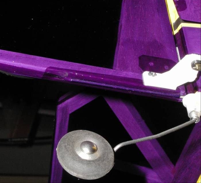

These Plans suck! How is the tail wheel mounted? Do I chop the Vertical rod down or does it get stuck in the rudder? HELP PLZ Pics Most helpfull! Thanks, Cool plane though!

Here's what I did...
I bent the wire flush with the bottom of the rudder and covered it with Ultracote to hold it in place. I've done many models this way.

Thats a great idea thanks!

Or, get one of those Sullivan tail wheels and save the problems. The spring on them absorbs any shock from ground handling before transmitting it to the servo. My personal opinion, of course.
