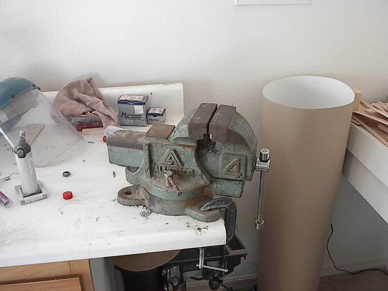

Wire bending becomes easy after you have made A bipe or two or had to make up some landing gear. You just need A big vise and file in some notches for different sizes of wires. Most hobby shops carry A selection of wire. Don't use heat to bend it or it will break at the heated point when you are landing. Guess how I know.
Only place to add or use heat is when soldering and I use A small torch. I'm adding A couple of photos. This is A cheap tail wheel assembly. I drilled out and used A 4-40 tap as A set screw then used fuel line over the hex head screw and used A small servo screw to hold the tube to the bottom of the rudder. This way it takes the shock without hurting the rudder. Very old school trick.

I did use a vice and pure muscle to bend the tail gear, I have not yet build the mains, but am planning to buy pre formed gear for it.
I like your tail wheel set up, I wish I had seen it before I did mine. Right now, mine is just epoxied into the rudder, so it will take a beating. I will try to pry it loose and redo it.

I have about 6 different types of tail wheel assemblys on different planes so if you look around you will find A lot of choices. What I showed you was just something that may have come in A kit at one time and I just addapted it to the plane. Most my tail gear uses springs attached to the pull/pull system for turning. If you are landing correctly you won't have any problems with it the way you have it but in time the hole in the rudder gets loose. You can install A piece of brass tube in the rudder next time to keep that from happening. See, just so many ways to do something.
