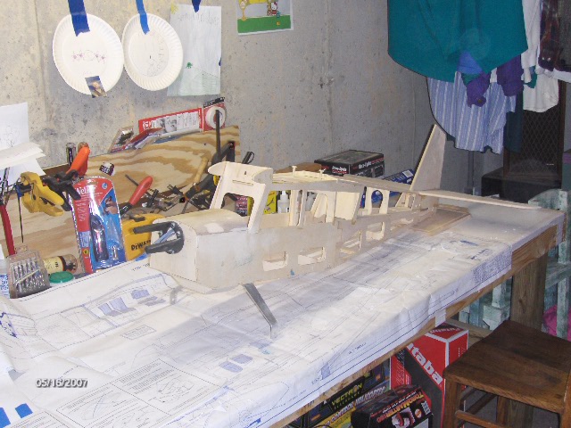

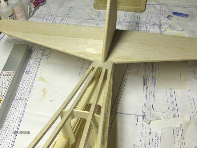

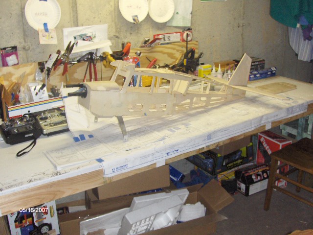

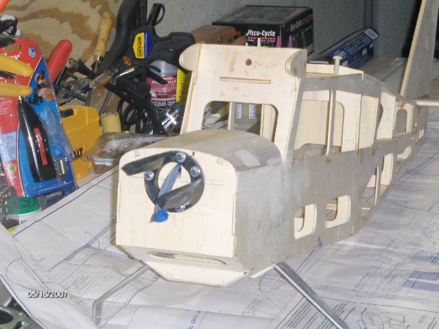

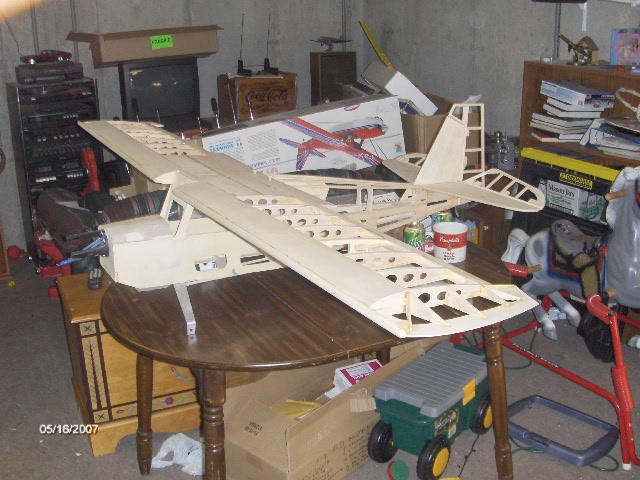

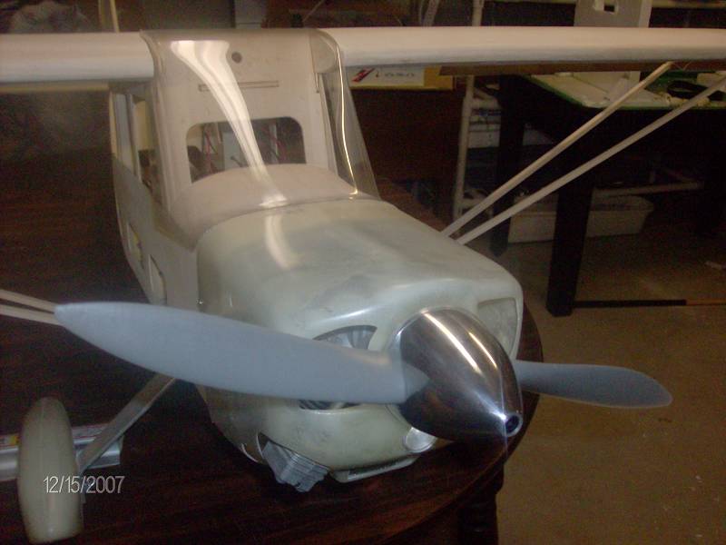

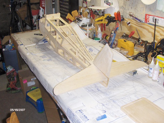

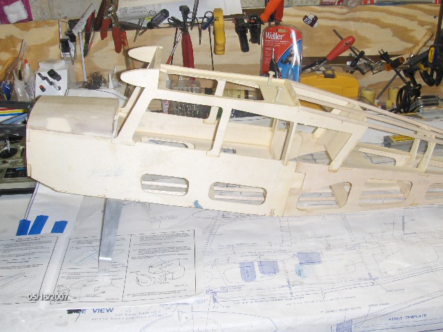

hello all! have finally made progress on citabria! nearing the end of the build! have been having probs with computer lately so sorry for any duplications. thanks to NCIS and rcu for help and support. i wouldnt have gotten this far without. here are some pics hopefully.

lookin good i think i might have to make one

Stiffen up the bottom stringers with some spruce and get Stan's Fiberglass cowl and wheel pants - well worth it.

Looking good to me!!! The Turtle Deck looks great. Keep plugging away at it.

Nice frame-up - you're gonna love this plane. What engine are u planing to use? I had both saito and OS 91 4-stroke in mine at several times and they worked well.

hello luv bipes! i will be using a magnum 91 4-stroke as i have one. did u mount the engine at an angle or inverted? just wondering if you had any fuel probs and how it worked for ya. this is my first kit and four stroke use. i have a two wonderful daughters
a wife and full time plus job. it seams like i have been working on this thing forever!
any tips or other suggestions would be greatly appriciated. thanks for comments

Engine was 225 deg from vertical to get exhaust out the bottom of the cowl and had no fuel suply problems. As mentioned above replace bottom fuse stingers w/ basswood and firewall w/ real aircraft ply to ensure greater longevity. Good luck.

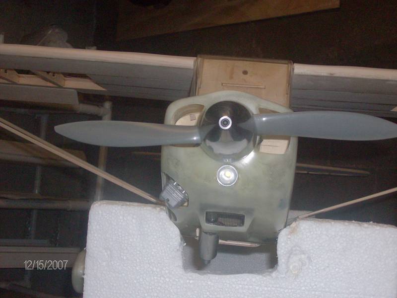

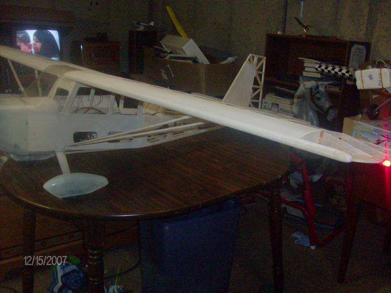

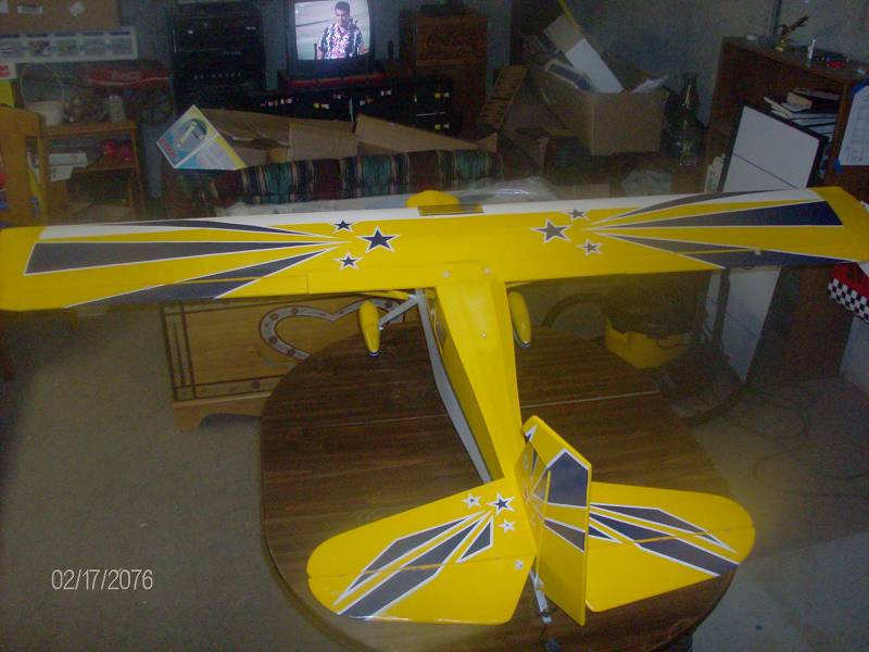

finally ready for covering! will be dropping off to club cover man after christmas. theme will be cub yellow and white with starburst
patterns my daughter desinged.

Very nice ! It will look even better with the pattern I designed on it. Can't wait til' the spring to see that thing fly out at the field.

Whose fiberglass? Plane looks like it will be sweet.

thanks sitnfly.
fiberglass cowl and pants are from fiberglass specialties. they are very well done and fit nicely.

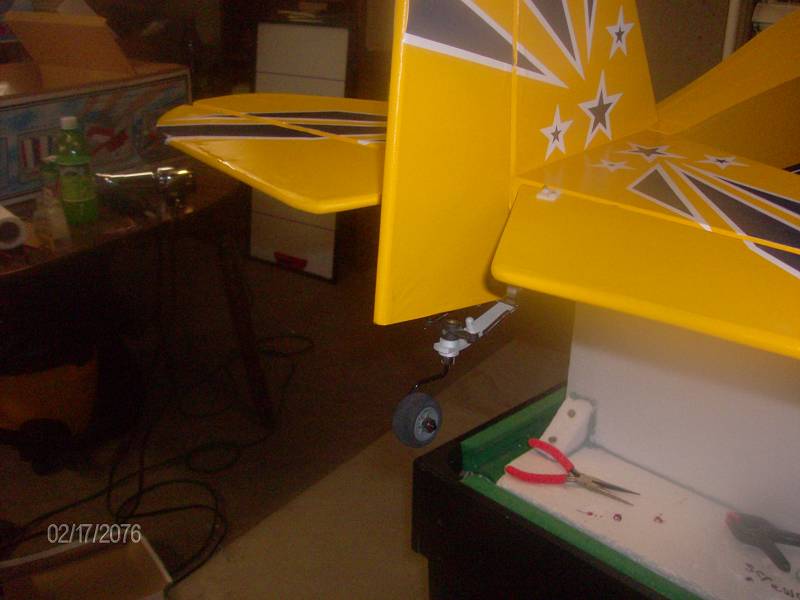

Old 02-17-2008, 03:27 PM
andrew wisc.
Join Date: Mar 2005
Location: milton, WI
Posts: 203
Default RE: midwest citabria build thread 3

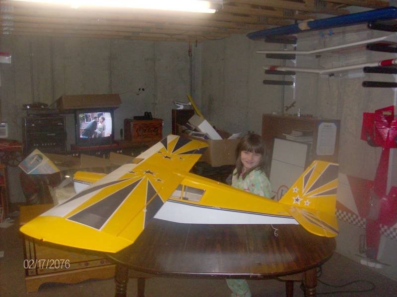

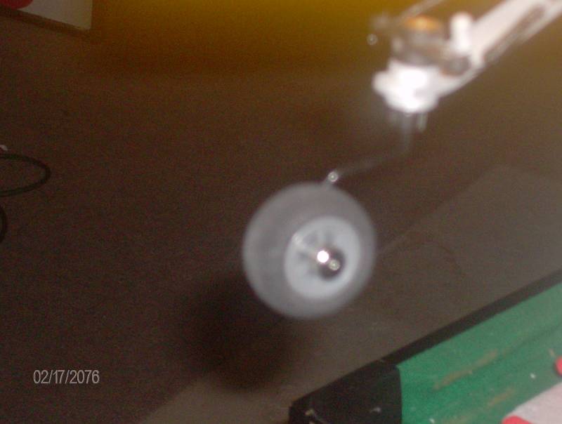

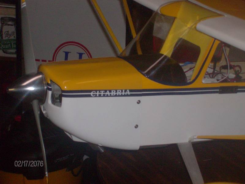

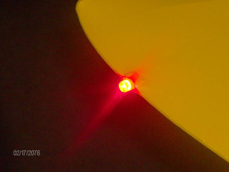

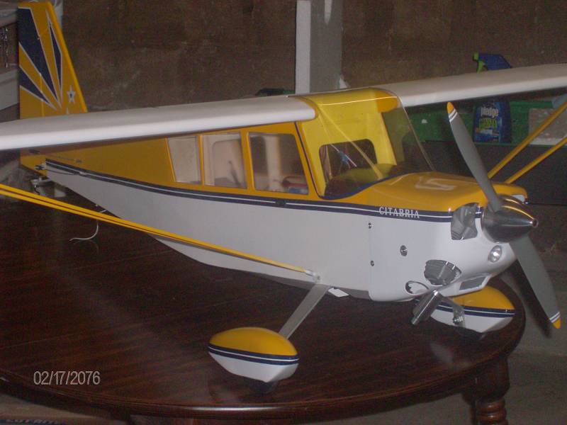

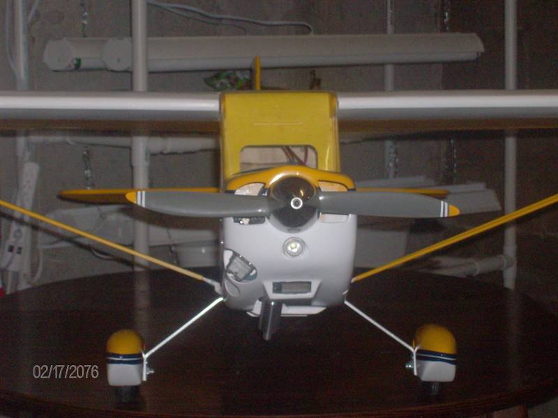

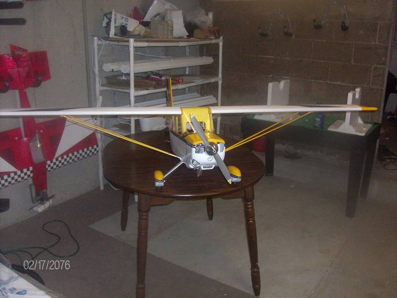

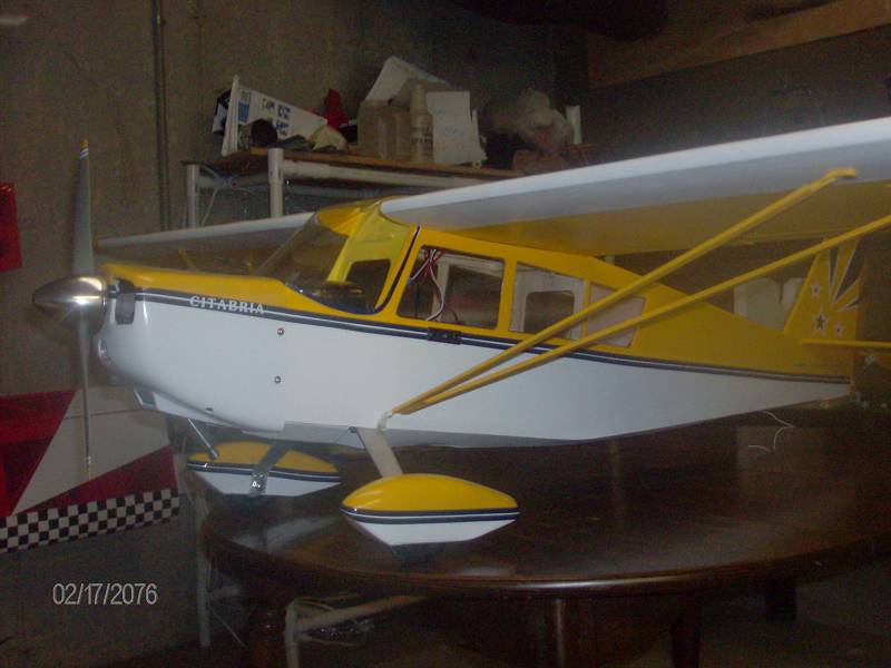

Well, its ready to maiden ! Its been a long road but, enjoyed the build. I'd like to thank, NCIS for help during the build, for support, and for the awesome paint/finish work, thanks for motivating me in kit building. Next, I'd like to thank, Club coverman, Bill Lipke for the great Solartex covering job. I would like to thank Callie Graphics (www.calliegraphics.com) for the wonderful modified starburst grpahics, which my daughter, Allison - TakingFlight96, designed for me. I would also like to thank her for being a great daughter, and her support during the build, help with finishing chores. I also want to thank my other daughter, Amy for help punching parts out of die-cut sheets. And last, but not least, thank you for all fellow RCU'ers who have helped along the way. Heres some info for those intrested -
Powerplant - Magnum 91. 4 stroke
Radio/Gear - Futaba

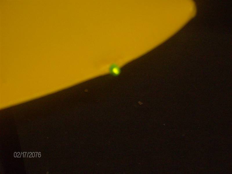

Working Navigation Lights - Homebuilt
Scale Tail Wheel - Great Planes
Prop - APC 14 X 6
Fiberglass Cowl/Wheelpants - Fiberglass specialties
Covering - Solartex - Cub Yellow, White
Spinner - Great Planes 2 1/2 in. aluminum
Wheels - Great Planes 3 in.
Thanks to All Again !
andrew wisc.

Beautiful job! It's great to see the young ones involved...especially with their unique talents. Thanks for the post!!

Hey!!!! Well, what happened during the maiden flight??????[]

very nice looking citabria. nice flying too! i prefer glow power . four stroke for a scale like sound. i like citabrias no matter what there
powered with. happy flying andrew wisc.
