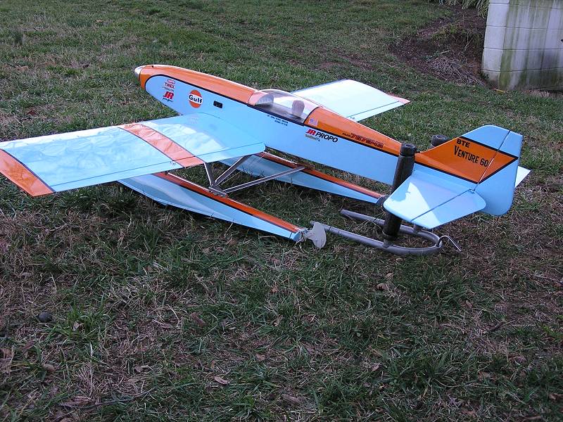

Thanks for the compliment. Here's the Venture on floats. She's got about 100 flights now.

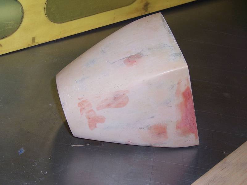

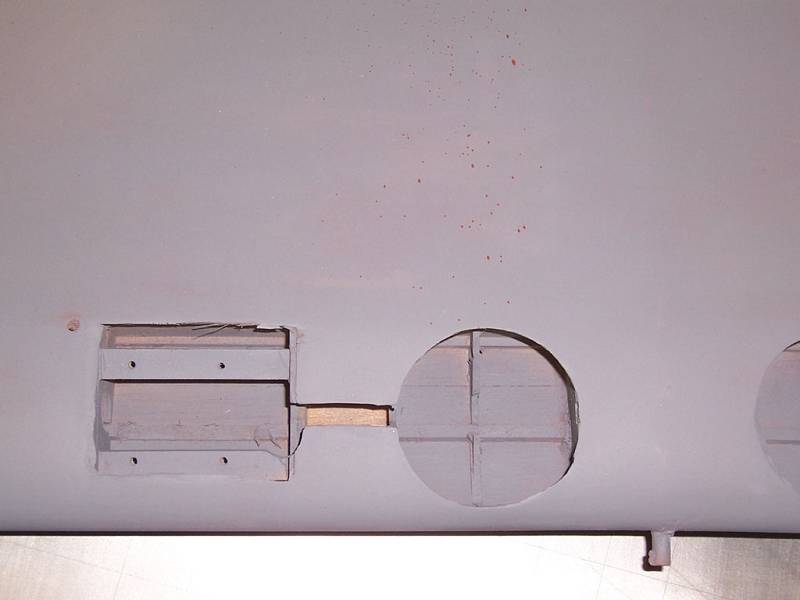

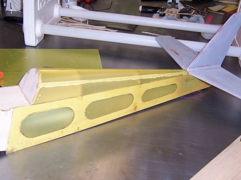

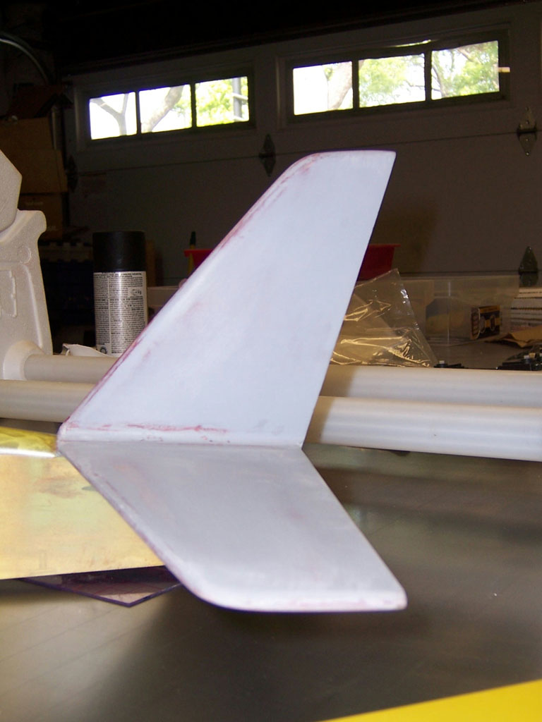

I'm in the process of my 4 * 40 mod build. I sheeted and glassed the wings. Clipped the wings one bay and added rounded tips. Added air retracts. Modified the rudder to be more like the one on the Venture. Built a glass cowl and am planning on an inverted 50SX. I'm covering the fuse in flite Skin. I'm also adding nav lights.

Here's some photos.

Lookin good
Your glass on the fuselage should fix one of the two weak areas of the 4*, Your retracts elimanate the other.
Thanks for the photos

Hopefully, the modified vertical stab and rudder (I'll have to take a photo of the rudder) will help with the pitch coupling.
It'll be interesting to see how the effect of higher weight and lower drag will affect performance. I still have to refine the shape of the wheel well openings and decide on whether or not to add inner gear doors.
