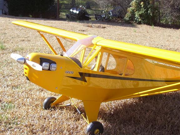

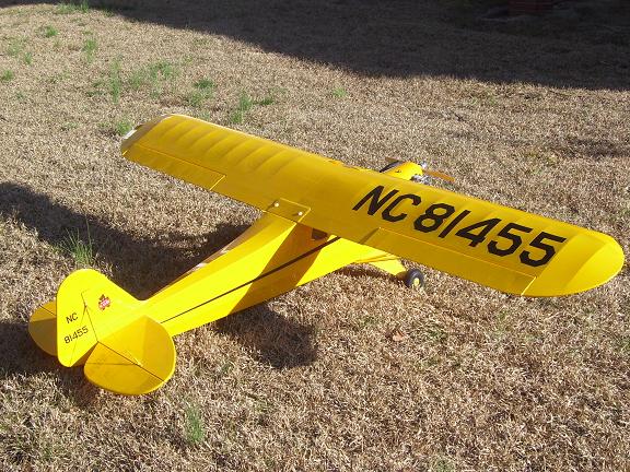

I built the clipped wing version of the Great Planes .60 cub. The instructions give you information on adding scale details. The wing span is 83 inches. I am powering the plane with a Saito .91 4 stroke. Sounds great on a slow fly by. See attached pictures.

More pictures of my Great Planes .60 cub.
Tim

Thanks, I am fortunate to have an airplane museum close by that has a Cub in its inventory. I was able to take lots of pictures of it. This was my second build, my first was a Kadet Senior. I am currently building a Top Flite Cessna 182. I have been taking pictures of the build progress, but have not posted any of them yet. I am thinking of building another Cub and covering it with fabric when I'm finished with the Cessna.[8D]
