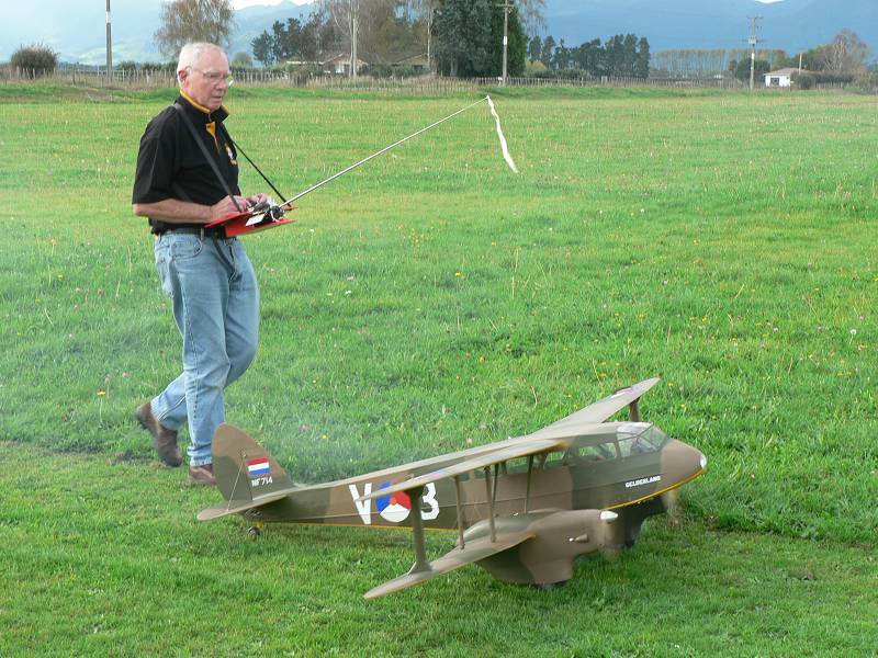

I came across this beaut model at a rally here a few weeks ago. I don`t know the origin of plans etc - but could probably find out if you`re interested.

Alpha Whisky,
I would very much appreciate knowing more details of this lovely effort.
