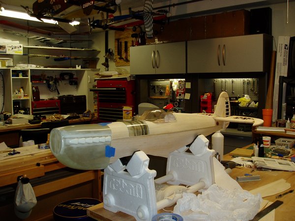

Here is where I am currently at with the fuse. The sheeting wasn't flush with the firewall yet so ignore the fact that the cowl isn't square. I just taped it there for the picture. I have a full write up on my build over at this link: http://www.rcscalebuilder.com/forum/...et=last#174878
